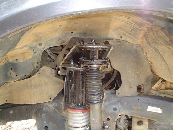

    Pretty sure that is it, with different Ucas

    No the TM one uses a shock instead of that spacer thing

    But good DP lifts use better spindles
    Look at the fabtech one

    The ball going spacer is the extra shock...

    Also 6” lifts while yes lets you fit 35” (which are stupid expensive anyways. Actually raise your center of gravity whih means you can roll easier
    Also you don’t really gain any ground clearance because you got that big bracket dropping down
    Its also very hard to revert back to stock

    In effect it acts as a McPherson strut. The entire ball joint shock doohickey acts as the upper control arm.

    Wouldn't surprise me if you have to drill extra holes in the frame to make that part not move.

    Thats not how a bj spacer works
    There is a whole thread about this, and that thread is where me and @jbrandt got out jokes from

    The entire thing is a weak point. :boom:
