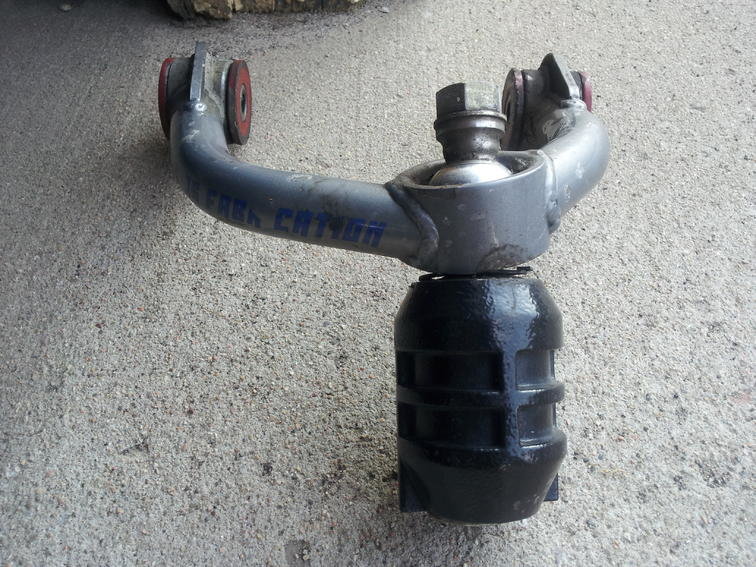

    Why would you take that beautiful piece of Engineering that Total Chaos made and disgrace it with a ball joint spacer?

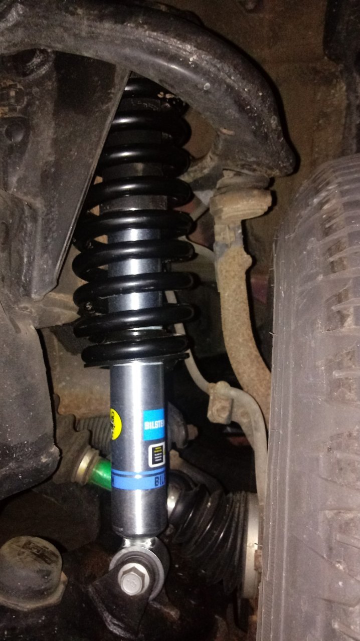

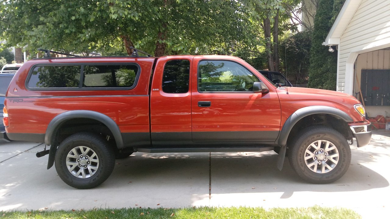

    If your tearing the UBJ but not CV's your doing something wrong. Usually if one is good so is the other and vice-versa. By putting a BJ spacer, your adding a new stress point and something new to break. :smack:
    Whats your lift setup? Bite the bullet and grab some JBA or SPC upper control arms.
    For example, when I incorrectly installed my lift the first go-round this was the result: 0325182040a.jpg
    No, I did not drive on that, I simply dropped my 5100's down 2 notches. But see that both my CV and UBJ boots are pinched here.

    If you dont want preload, ditch the top plate spacer, drop those 5100's to zero, and install some quality coils like OME 880 or 881's. All issue will be solved, and it will ride awesome. Heres mine with 880's: 0617181420a.jpg
    CV's have a slight pitch, ball joints appear at a stock angle. No complaints what so ever.
    Also, that spacer is a stress point. I look at it from a machinist perspective. What cheap Chinese recycled Iphone is that thing cast from? This is the UBJ were talking about here. If that fails, your donezo, loss of control etc... Could even total your rig.
