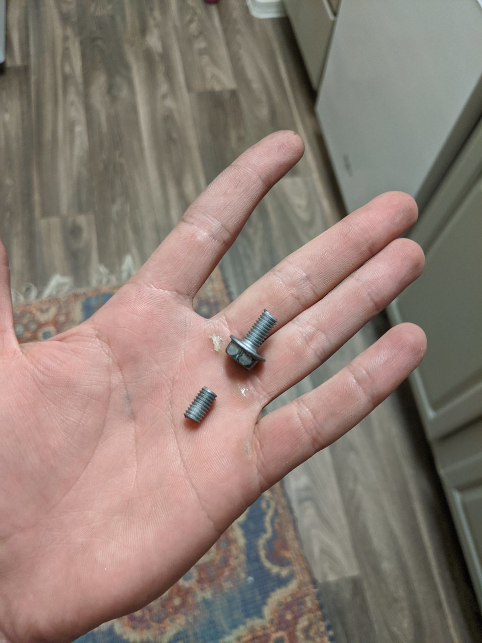

    And i snugged up valve cover bolts but not tight. Probs don't need to worry about it leaking unless i tightened p tight right?

    I know theyre low spec for torque

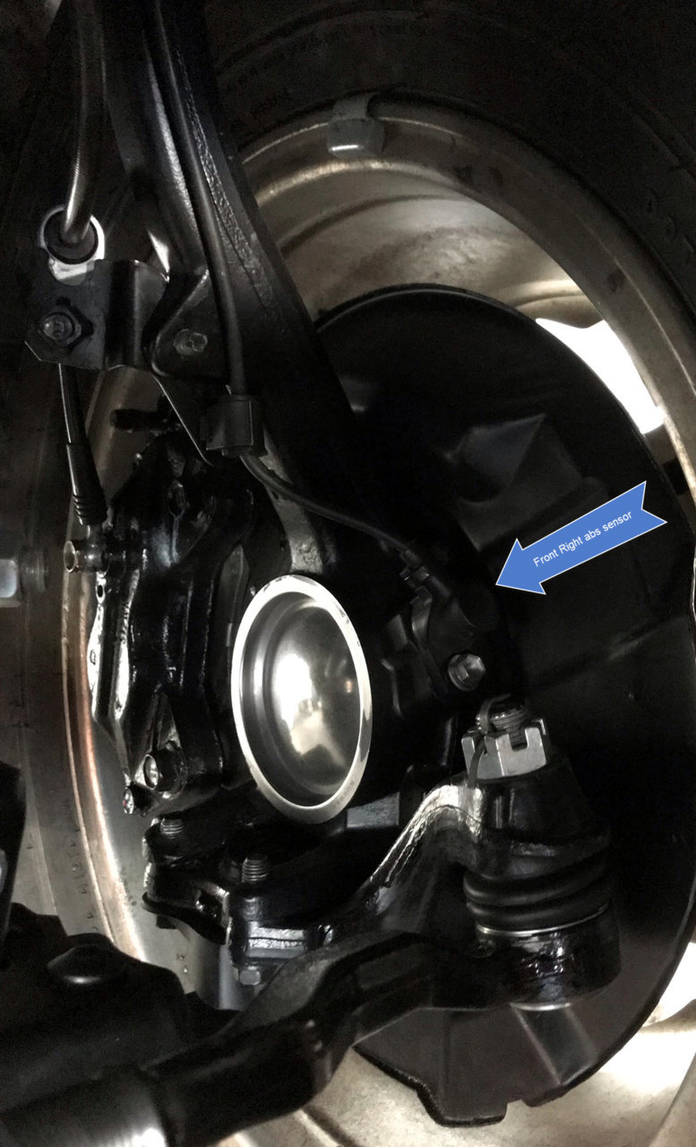

    Well, we gave it an E for Effort. The rear abs sensor has to much girth to fit in the front abs hole.

    Thanks! Yeah didn't strip em, just did this lol

    Oh shit! Glad to see you got the broken section out. My personal rule of thumb when it comes to tightening bolts into aluminum without a torque wrench
    Use a short quarter inch ratchet and only go as tight as one finger on the end of the ratchet handle will take it
    Or like you said a quarter turn past finger tight :thumbsup:
