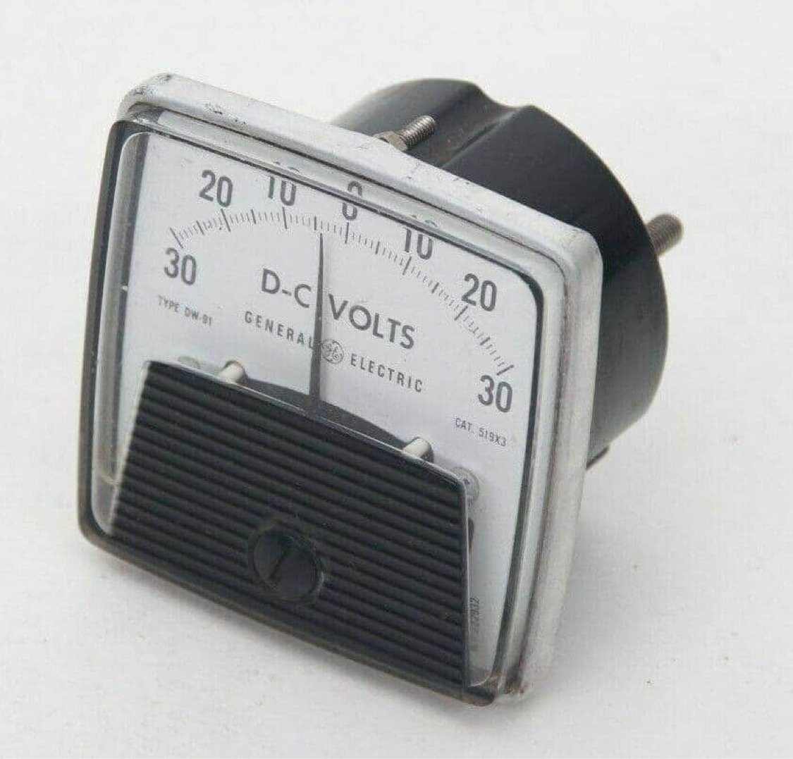

    @BartMaster1234, do you have any more specs for that 0-100A ammeter, or a link to it on ebay? Meters like the GE one typically use precision shunts, and the shunts they use have a current rating and a millivolt rating such as "100A, 100 mV" or "100A, 200 mV". The shunt is basically a very low resistance and it converts the 0-100 Amp current to a millivolt signal that connects the two shunt posts to the meter . Precision shunts are quite pricey, you can get cheaper ones, but you have to know the mV your meter requires for its 0-100A range. One things for certain, you need a 100 AMP shunt for that GE ammeter, not a milliamp shunt. If you had test equipment that could provide a milivolt signal, you could test to find out how many millivolts it takes to drive the meter full scale, that would be your millivolt value.
    And if you use an external shunt, you have to make sure its well insulated on the mounting base and protected from a short (enclosed in a housing) or you're going to have a bad day.
    FYI, I did see on ebay some cheap automotive range digital meters with shunts provided for the current and voltage measurement as well, i don't know how trustworthy those are.

    Hey! Here is a link to the meter. These gauges are oooold, so I couldn't find anything when I googled any of the numbers on it.
    https://www.ebay.com/itm/GE-DC-Amperes-0-100-Shunt-External-Type-DO-91-Panel-Meter/273660384487
    This is the shunt I was hoping on using:
    https://www.ebay.com/itm/100-Amp-Sh...-Shunt-Screw-and-Bolt-Connection/271914952205

    Some of those older style GE ammeters appear to use 50mV, 100mV or 200mV 100A shunts, so I wouldn't count on those shunts being the right. The ebay site you linked to for your meter I did find this information:
    GE DC Amperes 0-100 Shunt External
    Type DO-91
    50-162121ECDK2
    AA-12
    I Googled the part number 50-162121ECDK2 but could not find this model (its an old GE meter). I did find a GE 50 millivolt meter with the part number NOS NIB 50-162121, which makes me suspect that the "50-" MIGHT mean a 50mV meter for your 0-100A DC ammeter, but I just can't assure you of that:
    https://www.ebay.com/i/184324318742...MI_LDVspvd6gIVGey1Ch2hrAaGEAQYAiABEgIhCvD_BwE
    Do you know a technician who might have access to a mV signal generator who could test your meter?

    I couldn't find anything specific for that meter, but these are also GE, and suggests that what you need to know might be stamped on the meter. It also gives wiring examples.
    https://docs.natlswgr.com/docs/W1000093.pdf
    davidstacoma likes this.

    Wow, that's really cool. Thanks for finding that.
    Fingers crossed I can get that one to work, I really like the look of those old GE gauges.

    Edit: That's close, but his is a D0-91 series, do you have a cut sheet for that one? But you might be right, the mV rating could be stamped on the meter body somewhere.

    Just be careful with the voltage vs current thing. The mechanical movements I've used in the past operate on current, and if you just put a straight voltage across them you'll burn them up.

    Those meters do require a mA current to drive them, the shunt applies a mV voltage to the meter, and based on the meter winding resistance, a mA current will flow through the winding. For example for a 100A DC ammeter requiring a 50 mV shunt, a 10 ohm meter winding resistance with 50 mV applied would cause 5 mA to flow to make the meter go full scale (I=V/R).
