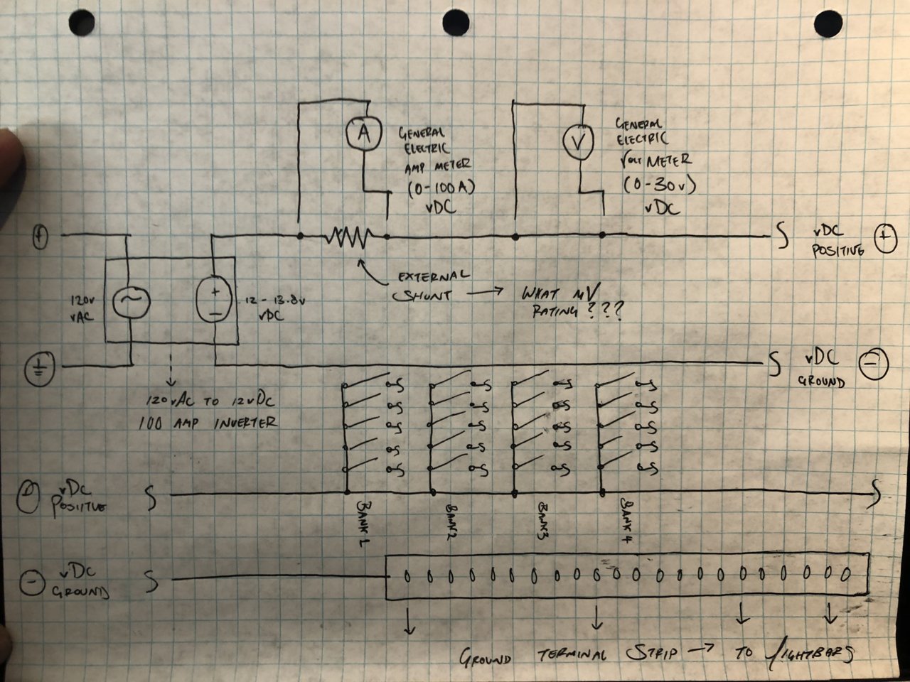

    So what I'm building is a 120vAC > 100A 12vDC inverter to power about 10 halogen and LED emergency lightbars. Basically I'll have multiple banks of switches that operate the various functions on the lightbars.
    The ammeter I know you wire in series with the load, and the shunt just brings the voltage down enough so it (doesn't blow the meter? I don't know much about shunts except they act as a resistor). As for the vDC meter, is that as simple as wiring in parallel with the load? Or do I need additional stuff to make it work.
    This is a rough schematic:

    Not bad work there! Just put your 0-30V meter across the 12-13V output of the inverter, you show it connected to a dead short as drawn. And you need to fuse your circuits as well.

    Hmmm. Ammeters in a DMM are a very low impedance, and if hooked up as the GE one is there, would just bypass the shunt resistor and blow a fuse. I'm not certain what the correct wiring is, but I'd want to be before I plugged that monster in. 100A through that meter might be exciting.
    What are you using to get 100A at 12V? Those kinds of supplies are usually pretty spendy. It might be more cost effective to break it down into multiple lower power systems.

    Is the short where I didn't connect the lines for the meters to the load? Sorry for the dumb questions, I haven't been formally trained on this stuff - just working off experience haha

    I collect emergency vehicle lightbars, they draw a great deal of amps. Especially the old halogen ones from the 70's to early 2000's. My Code 3 MX7000 draws about 32 amps in full code.
    I'm using an RV battery charger for this, here it is on eBay:
    https://www.ebay.com/itm/RV-Convert...battery-Charger/283325214123?var=584230368941
    As for the amp meter, I don't even know if I drew it correct on that schematic. I was going off a google image of an example of one.
    I know the shunt has four terminals, two for continuous load, and two that have the stepped down voltage that feeds the meter. Wasn't sure how to draw it.
    What I am concerned about is, can the vDC meter handle 100 Amps? I can't seem to find any information on that.
