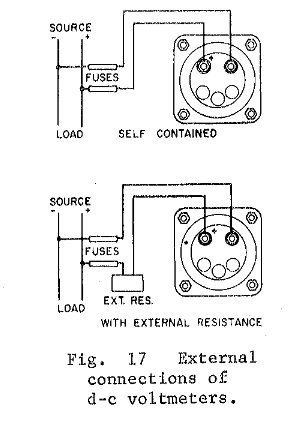

    You'd want it across the +/-
    Ahhh Nice. I love the 4 40A fuses :laughing:. If its not enough, you could just add some batteries, too.
    The VDC meter shouldn't have any current running through it. It is just sensing the voltage difference between + and -. So you won't find a current spec for it. But you will want to make sure whether or not it needs an external resistor. This schematic looks right to me:

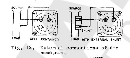

    I'd have to do some digging on the shunt, but what you're saying sounds right. The load current passes through the shunt resistor, creating a voltage drop across the shunt resistor, which the ammeter then reads. This looks right to me:

    Thanks! I guess my only issue now is finding what mV rating the shunt needs to be.
