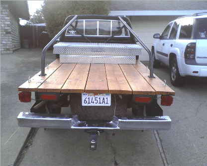

    Yup. With most schools going online this fall more college kids should be able to work 7-3:30 5 days a week and do school in the evening. Factory jobs pay more than the minimum (mostly) and give you weekends off. Id take a labor position with regular hours anyday over making pizzas. Been there, done that got the t shirt. It sucks.

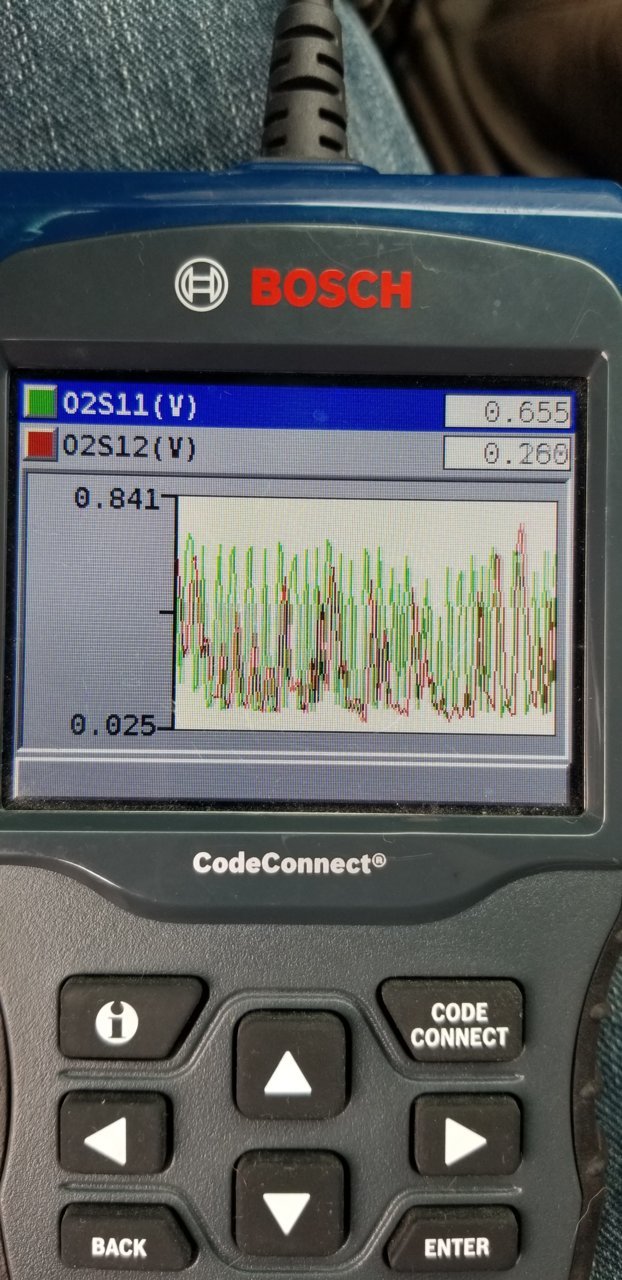

    Got the best CEL code ever today. Truck felt sluggish the last couple days and smelt a lil funny. P0420!!!!!!! Catalytic Converter has to be clogged. This truck only has 1 unlike newer tacomas. Makes me believe that @Empty_Lord was right all along about the truck running odd. Just now getting the code so I have no choice but to check it out

    Get you a code reader that can map out live data
    I've posted this on other pages a few times now but I need a new CAT and this is what my data looks like.. if yours is similar you definitely need a new one lol20200707_094845.jpg

    Yup. If rear o2 sensor doesn’t delay ~1 second behind the front a/f you have a dead cat.

    For a simple flatbed, Id charge for the price of the steel and consumables and maybe $300 labor, more if you wanna get fancy. All it is is a frame with a flat plate on top. Hardest part with most things like that is just figuring out how to mount the stupid thing.
