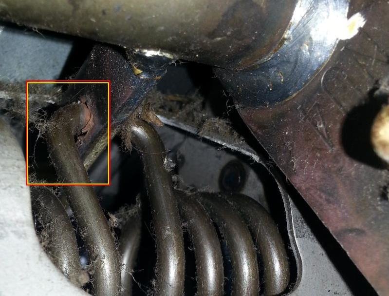

    The typical clutch pedal wear from the newer style spring. It would fail to return fully which would cause the clutch not to fully depress. It did it a few times but I would just pull it with my foot.
    223806d1477025141-5-speed-clutch-pedal-s_8919548f04a1f1ffb928971b568c76669f390014.jpg

    Oh man that would totally make sense. The clutch wasn’t going in all the way.
    If you take the rubber pad off the clutch pedal you can see how shiny the metal is. I got a new one from the junkyard. Definitely was worn well.
