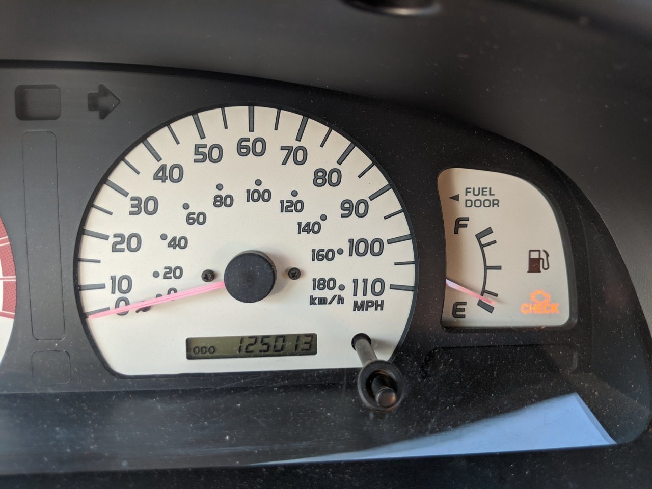

    Gonna pull the code when im off, finally popped yesterday when it was rough idle on startup and i feathered the gas. P sure its the #3 injector gunked up bc the trucks been stinking more too. Only rough startup sometimes for 5-10 sec before settling, and a high rpm missfire still

    I've had an intermittent CEL for months. I don't disconnect battery or clear it with OBD11 tool. Last known MIL was P0420 which cleared itself after replacing B1S1 and B1S2 with genuine Denso a/f and O2 sensors.
    I haven't been able to scan while CEL is on but scan after CEL goes out shows nada, zip, zilch. WTF
    Any idea? The Y pipe donut gasket is my guess because P0420 would be the only code for exhaust leak or am I mistaken?

    New gaskets when you installed 02 sensor? Reusing an old one could create a leak.
    In my experience (I have the same 2.7 and code issue) it's my whole CAT. Started with an intermittent light like you described and no history of code when it would go out. Now it's on all the time and I've got a nice strong gas smell when I sit and idle

    Haha, yeah whats bugging me most is its keeping me from throwing the lift on bc i wanna make sure i have money to fix if the case be. Yeah, gonna pull the injector tn if its still #3 missfire and see whats up. Hopefully its just bits of plastic i can smack or dig out and thats it, but who knows with my luck

    Yes, new gaskets, studs and nuts. I also cleaned flange surface well and looked for pits n cracks. Cat heat is optimum and no stinky just normal drops of water from tail pipe. Manifold is A ok also.

    Still got the new denso coil and ngk plug in there so thats the last thing on the list besides like a vacuum leak (pls god no)

    That can occur with only one cylinder missfire codes? Ive had p0303 pulled everytime

    if it's leaking coolant into that cylinder only I would expect so. Though the plug that came out should have been steam cleaned if that was the case

    Ill check coolant levels, but have had no white smoke from what i know

    It's possible... my 98 4runner with the 2.7 had a misfire in cyl 3 and I thought it was maybe a pitted valve or something cause I changed injector coil and the PO had put a new head gasket it.
    Aside from him fucking a bunch of shit up getting the head back in when he did the job he completely overlooked the crack in the head between the 2 exhaust valves:(
    Bought a fully built chinesium head for a company in CO for around 600 to my door. I've put about 1500 miles on that head no issues so far
