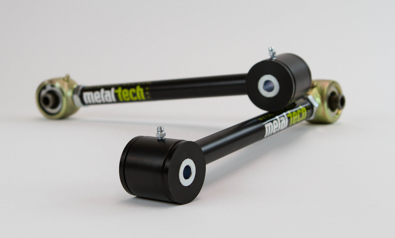

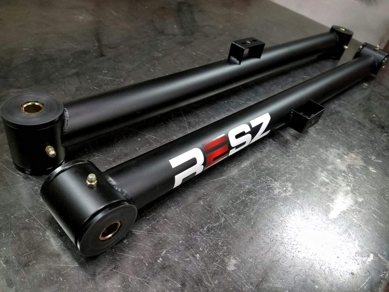

    Ordered these lower links last night. After talking to two members on here, we narrowed it down to poly bushings due to my driving style (which includes on road) plus ease of maintenance (if any really) -
    I may go with Currie Johnny joints on only one end though and that'll be for the upper links. Here's the set I'm eyeballing -
    The joints will require cleaning, and greasing as I was told roughly once a month. Sure it may annoy me a little but at least it's a total of 2 vs a total of 8 or more.

    It's worth it for the Johnny's on the upper links, my LC has basically the same setup and you'd be surprised how little actually gets up into the upper links just based on placement, if you're mostly on road... as my LC is.

    Re-greasing will keep them clean. They have zerk fittings.

    This is true, unloading the joints and cleaning them isn't great to do regularly because the big gland nut threads could become chowdered from frequent re torquing to the pre-load amount.
