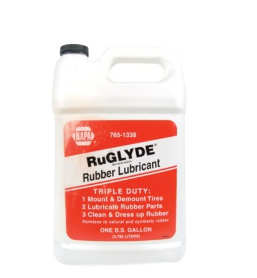

    Just returned from NAPA where I bought another gallon of Ru Glyde. I got started using it to keep from damaging tires on a mounting machine. Now, this is from the days when there were FULL-SERVICE service stations that would check everything under the car and squirt some Ru Glyde on bushings to keep the suspensions quiet.
    It has a soap content, I use it to clean under the frame and rubber bushings. That's how I keep old car suspensions looking like new. I like to use it on tires when detailing. It doesn't leave an overly sticky film. Just a good all-around rubber dressing.

    That's purely for rubber upkeep right? You couldn't use that to resuscitate old rubber parts?
    Do they even make a product to bring rubber things back to pliable?

    I have found some incredibly rare rubber bushings in junkyards that were all dried out and cracked that are no longer available for an antique car. I put then in a jar of Ru Glyde (e.g. completely covered in liquid) and let them sit for a few weeks. Basically I forgot about them. When I came back, they were soft and had returned to a pliable condition. They are new, but 100% better than when I started. Sometimes you can save an old bushing by soaking it in Ru Glyde. Just depends on how far gone and the original material.
