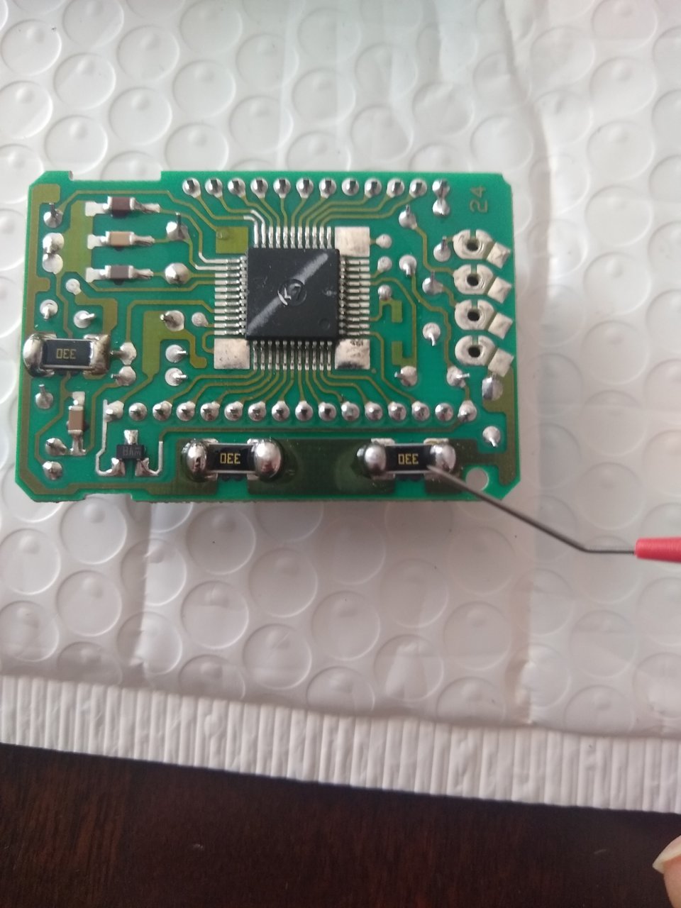

    When you press on the face it squeezes the microscopic breaks in the old solder joint back close enough for the current to travel. When you get it apart you'll likely find what 99.9% of those of us who have opened the clock up found. tmp-cam-2025918264627825360.jpg
    On the three similar resistors, the probe is pointing to one, you just solder over the existing is fine. I couldn't see the cracks in the solder with my naked eye. I just trusted that the issue was in that, and it was, my clock had been inop for a couple years
    Abeyancer[QUOTED] likes this.

    Nice! I'll have to tear into it then... I'm not a fan of the stock clock location but until I create my custom dash that has it built in I'd still like to know what time it is
