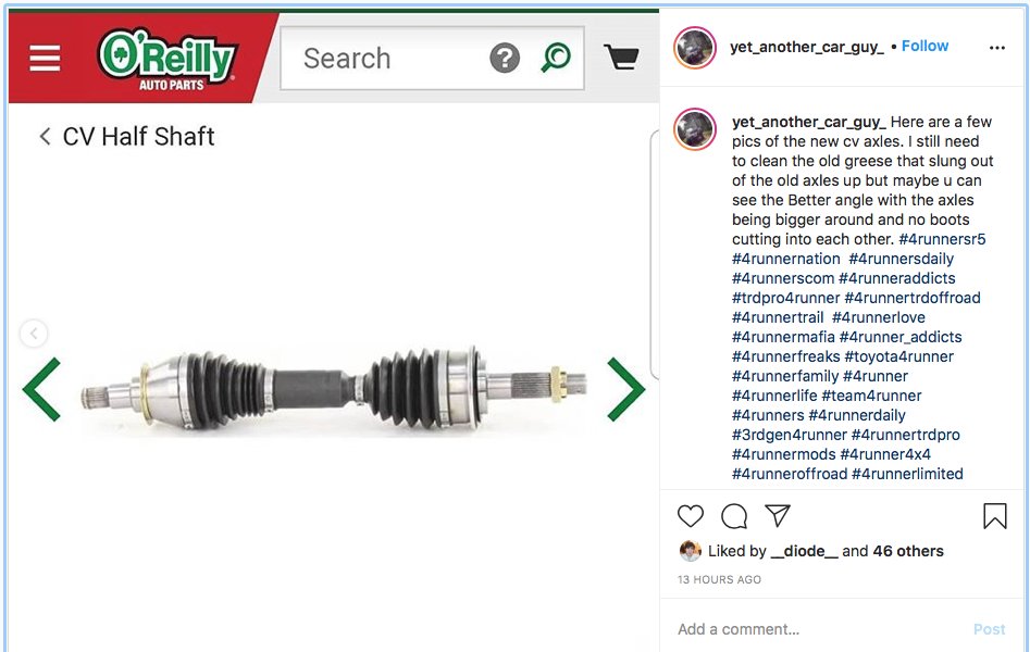

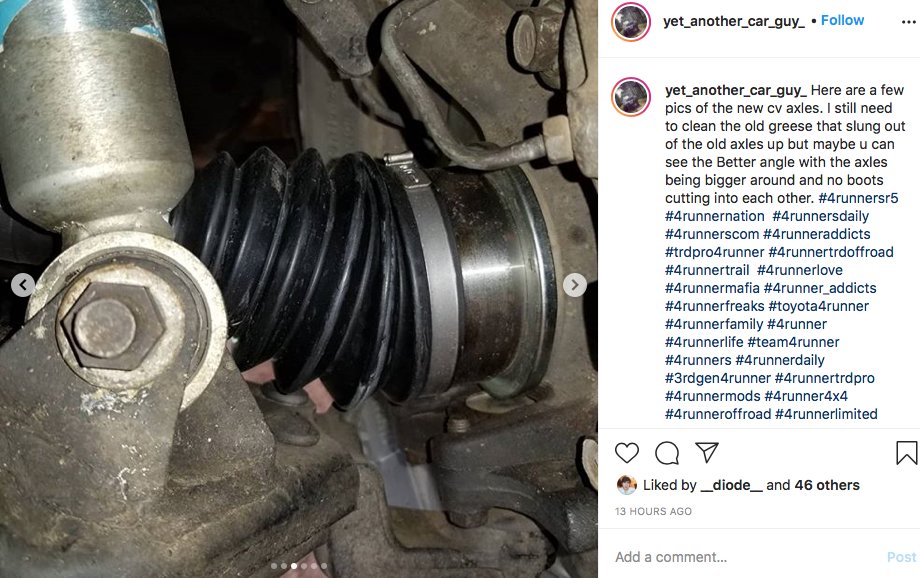

    I mean at least the inboard boots arnt being pinched
    On my 4 runner with a custom lift the I board joint was binding at full droop till I further modified it I wonder if it's a cv at both ends instead of a trunion type deal on he inboard joint

    Does that Instagram truck have a big lift on it then? Cause it sure looks like it's running bing to me

    That's what I was thinking...unless it's jacked up in this pic, hopefully it is otherwise that's gonna rub apart in no time lol

    You ever seen stock CV angles? Yeah that truck has a lift

    My buddies 4 runner had the inner boot rubbing %100 of the time and it's lasted since before he bought the truck, is his daily

    That is weird, but anyway I wouldn't want that kind of an angle on the CV at ride height. I've never had an issue with the outer boots rubbing like that anyhow, it's always the inners.
