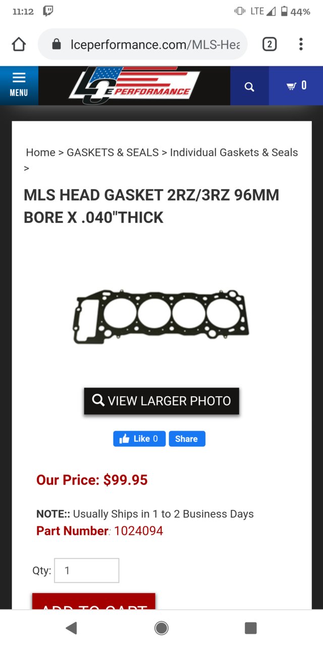

    What were ur symptoms out of curiosity? Ive got a rough idle start intermittently for the first 15 sec, and a high rpm missfire above 4k rpms

    Yeah absolutely, the guy was up front about bad valve leading to hairline cracks in head.
    If you catch it early enough the head will be fine. Not a bad idea to have a verified good head and valves ready to slap on it when you pull the head. If you spend the time to watch timmah or some other well made in depth DIY video and have a good idea of what you're getting into, I'd think it's realistic for a first timer with decent mech ability to be able to pull and install a ready to go head in a weekend. Friday night start tear down and cleaning, Saturday pull head and install new head and then Sunday buttoning it up. :D

    I'm uh, pretty sure yours is what you don't want it to be. Have the valves ever been adjusted? Toyota says every 50k for 2/3RZ or they will eventually crack the head

    Ive only driven the truck for 30k miles since i bought from the dealer. No clue if done before but assuming if he had maintained by the dealer. Id rather the HG at this point over a burnt valve

    This shit would be a cakewalk compared to a burnt valve. Im so sorry to the guy who found that in here

    Just buy the top end gasket kit from Toyota. It’s fairly priced and comes with everything you need

    Definitely this. It comes with *all* the seals.

    No clue if its the HG yet, i swapped injector 1 and 3 and cleaned it after pulling too. Well see if it continues to missfire, and where the code pops for

    I bought a whole new head casting and had a head built for my truck. The gaskets rarely go bad, but the heads fail often

    I had a cracked head on my 3rz from the 4R, I bought a complete pre-assembled Chinesium head from APRauto.com (based outta CO) it was awhile ago but I think it was just under 600 to my door. I got a headgasket and valve cover gasket (plus spark plug seals for the valve cover) to go with it. I had never done anything that extensive work wise on a vehicle before.
    Total job wasn't that bad. Took me about 3 days to put everything back together after getting the block back from the machine shop..... i probably could've reassembled it faster if I didn't wait 6 months to do the job:anonymous:
