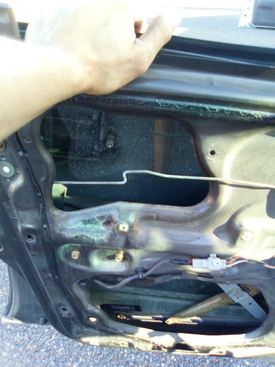

    Running Board Man
    Running Board Man Well-Known Member
    Feb 19, 2017
    #211024
    8,812
    Didn't replace anything just put that bend in the rod now the handle opens the door, win
