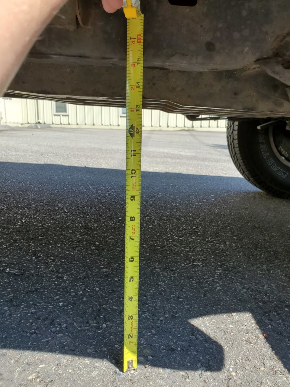

    Here ya go!

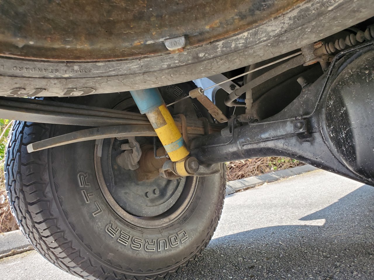

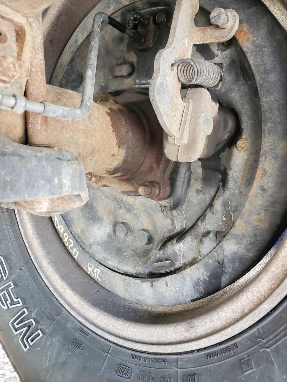

    @esxcli thanks for asking the question... look what I found when I was under there :(

    So, 31's cut in half is 15.5" to center hub I believe...and 13.5 ground to frame
    My ground to center hub is 19", setup for desert is 27" frame height and setup for crawl is 24" frame height.
    Desert: 27" - 19" = 8"
    Crawl: 24" - 19" = 5"
    Stock: 13.5" - 15.5" = -2"
    8" - (-2") = 10"
    5" + (-2") = 7"
    So... I have a roughly 7" lift setup for crawling and 10" for desert.
    Seems about correct?

    Upon closer inspection it looks like its weeping from my bleeder screw which would make sense since I just bled my brakes a week ago. Hopefully a new bleeder screw takes care of the issue
