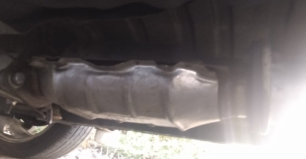

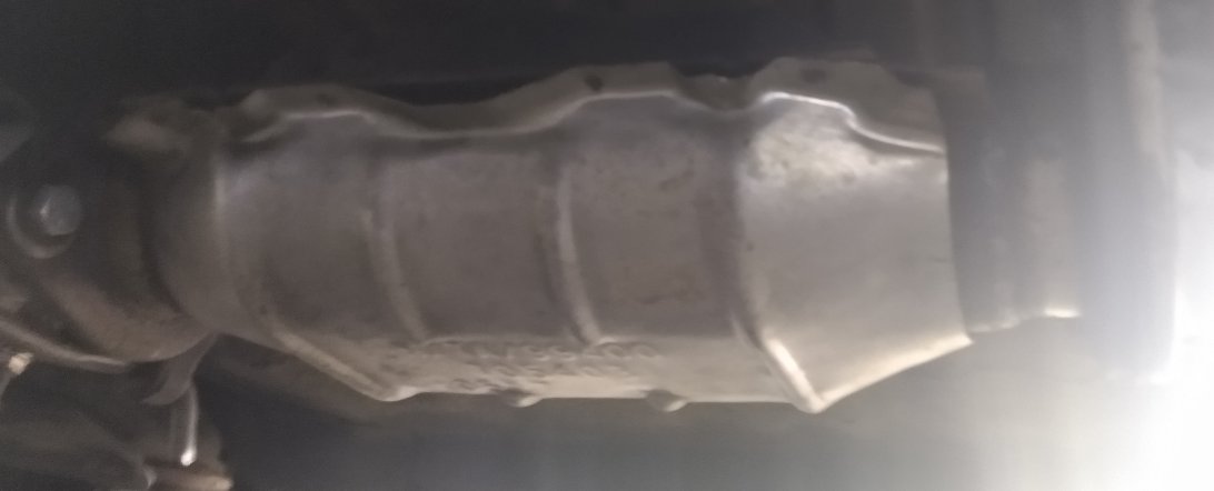

    CS_AR
    CS_AR Well-Known Member
    Apr 3, 2019
    #289019
    12,821
    1999 Tacoma PreRunner TRD
    Everything but the driveshaft. B03A - 410
    Here's a couple of poorly focused pics.
    Abeyancer[QUOTED] likes this.
  7. Aug 17, 2020 at 3:11 PM
    Abeyancer
    Abeyancer Not so secret, secret van guy
    Mar 28, 2019
    #288326
    13,245
    Jimmie
    PNW
    98 4x4 ex cab tacoma 3rz
    Fantastic, thank you!
    That looks way better than I thought it would ... poorly focused or not!

  18. Aug 17, 2020 at 3:41 PM
    Speedytech7
    Feb 20, 2014
    #123587
    57,864
    FCQM+VG Cheney, Washington
    It's less Tacoma and more mod
    So what's your budget, cause I think you can do better and if you have some stuff it can be reused. Like your downpipe is still reusable and I would totally take a rusty stock piece of stainless over that kink bent walker shit. And you can totally get better gaskets just as cheap locally from Felpro at any AutoZone. The straight piping is fine and the muffler will last a season or three, but I would probably use the stocker if it still is intact. But you can easily replace just the muffler if your piping is still bueno. I can't explain how crappy the Walker stuff is, the CATs are passable but they don't last long, I call em 2 year guaranteed at most.
