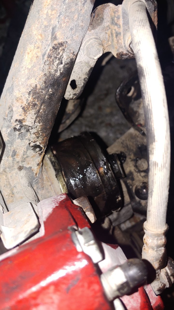

    I thought we agreed you installed a new axle with an invisible shaft
    Glad you got it driveable, just didn't want to see you toast your wheel bearing driving without a CV in the hub lol

    Lol true, but that's why I contacted you lol. Had to go to my neighbor for a cut off wheel. These axles and tough.
    I owe you Ryan

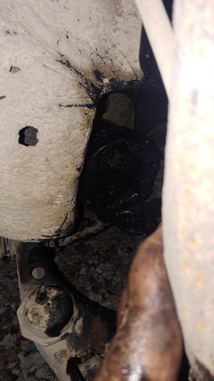

    You can toast a wheel bearing without a cv?
    How do you drive outta the trail when a cc breaks? Just pack an extra one?

    It's less Tacoma and more mod
    Pull the axle shaft out of the cup and just leave the cup bolted in the hub/bearing

    Oh duh... because you need the axle nut to keep the hub in:facepalm:
    What do you do about the open hole in the side of your diff? Carry around a rubber plug the size of an axle seal?

    Just leave the other side in too, you can remove the shaft from a CV and just have two cups. I always travel with a spare CV though, not often you blow up two in the same trip
