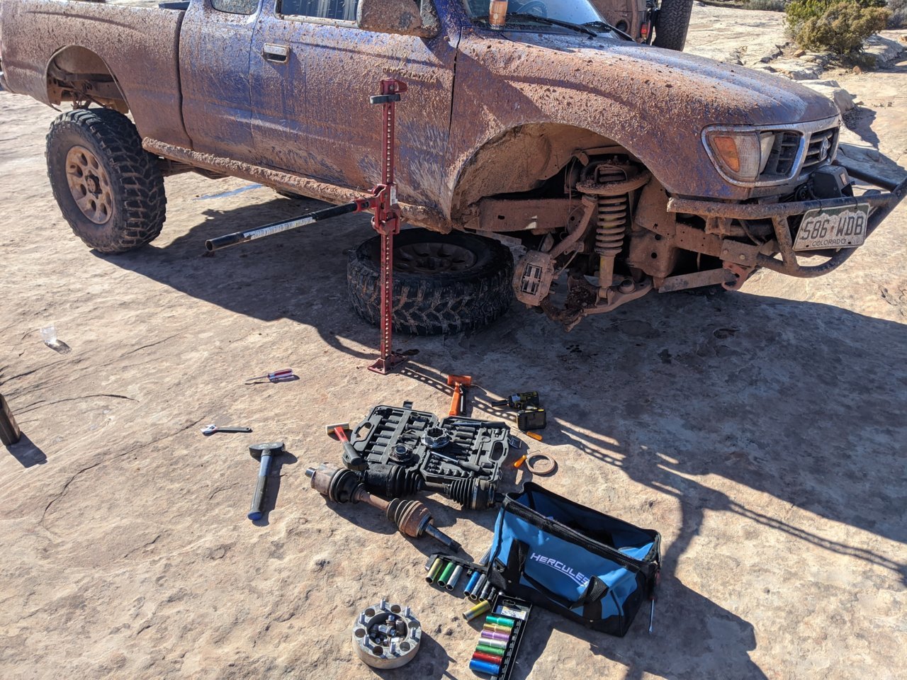

    Nice rainbow warrior sockets

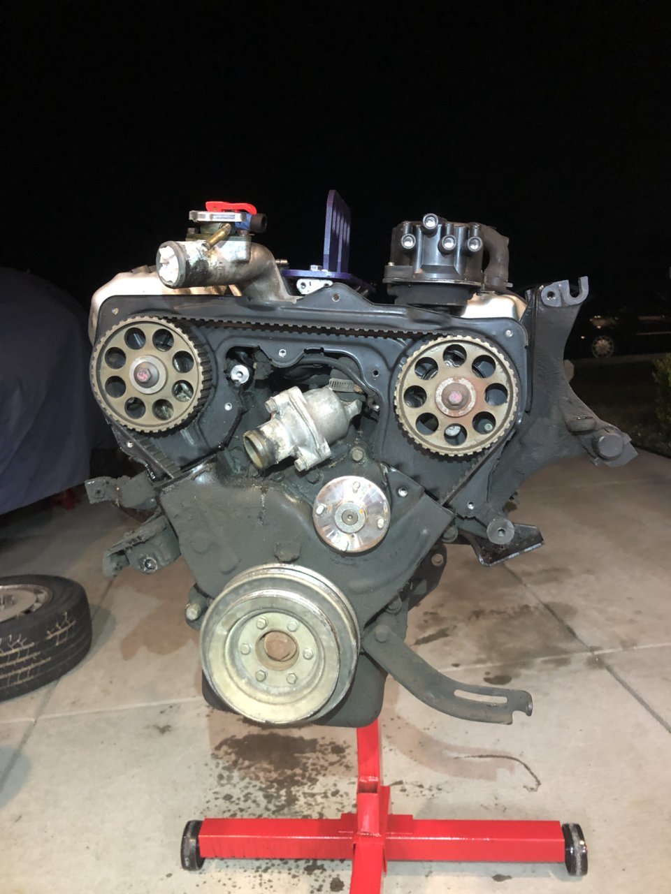

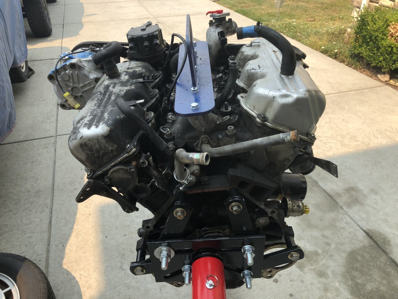

    Got the ol’ VG30 up on the engine stand.
    She’s nasty. My parts washer is doing double work. Been taking all the accessories and brackets off to clean them, I’m going to do the rest of the block with some Purple Power and my pressure washer.

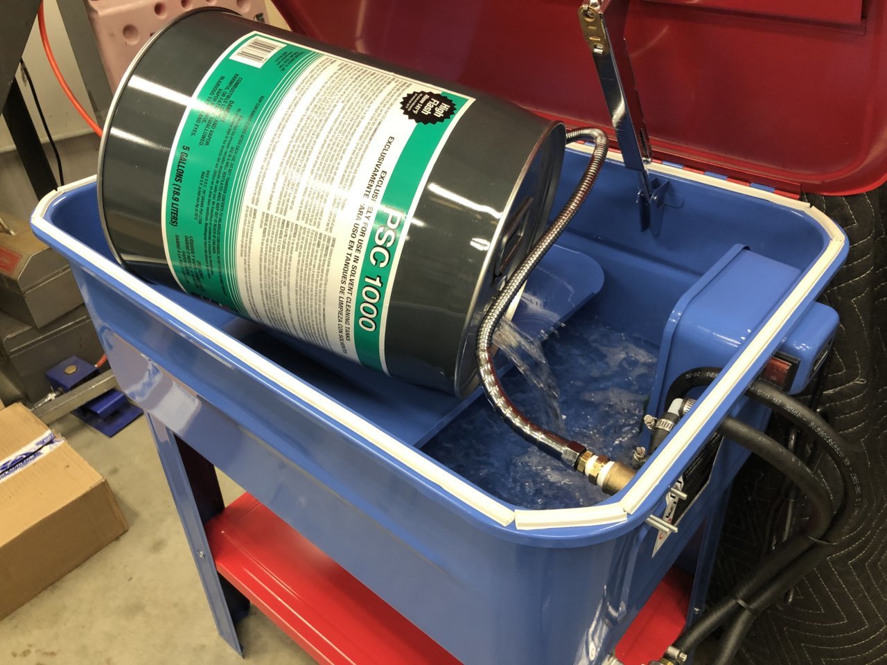

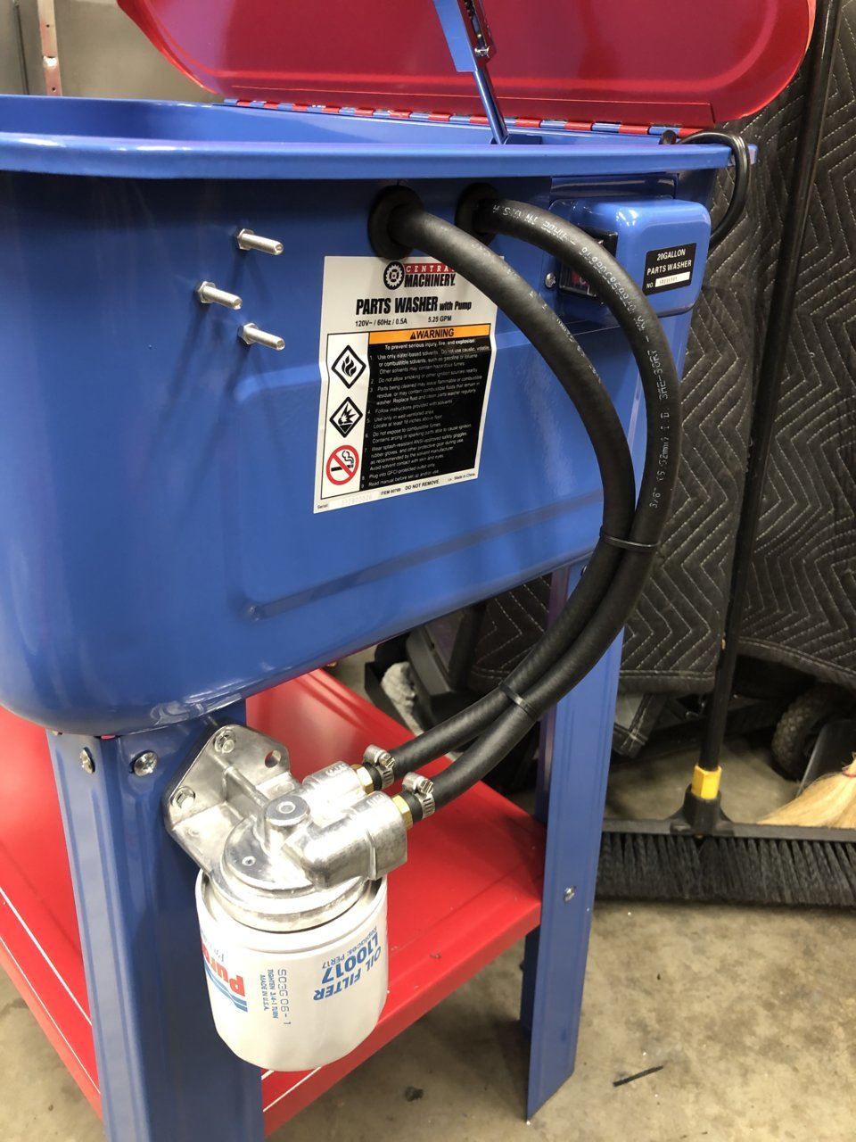

    I’ve been using my modded 20 gallon Harbor Freight parts washer. What I did is I used an automotive remote oil filter relocation kit and ran the solvent through it to make it last longer.
    Additionally, I ran some fuel hose and used a PEX shower fitting to mount the nozzle on the side of the basin.

    Interesting.....
    Looks like someone shops exclusively at Harbour Freight :luvya:

    Jebus those calipers suck with my 31s how do you do it with 35s or whatever you're running

    Very smart
