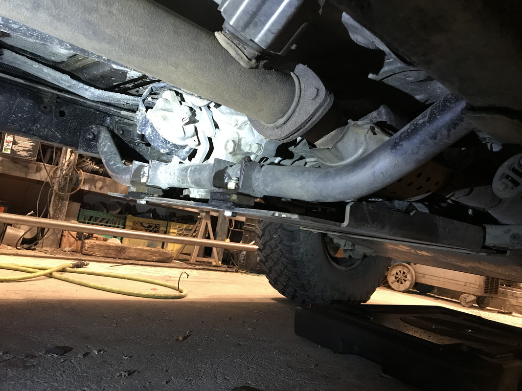

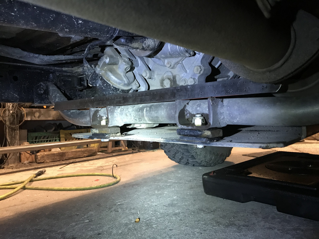

    Remember that cool crossmember I made? Well I tweaked it pretty good
    Oh and that cool straight frame I had? Well I tweaked that too.
    Looks like something beefier is in order.
    Crodell6 likes this.

    Time for the chromeoly and gussets

    you ever welded chromoly shits hard to do

    I think my best options are thicker tube, with a far better nlunting system to the frame, or the same tube I’m using (.120 wall), but more of it.

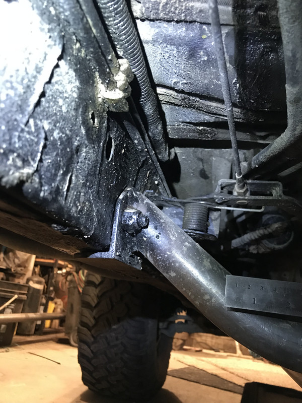

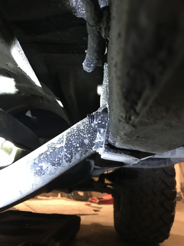

    Boxed frame? Nope. Didn’t see that. Should’ve known though as when I tightened the bolts it sucks in the frame.
    Now to come up with a rock solid solution....
