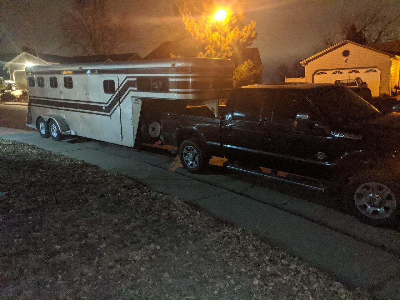

    I am glad that I don't have to deal with horses anymore
    Kwikvette likes this.

    Awesome trailer :thumbsup:
