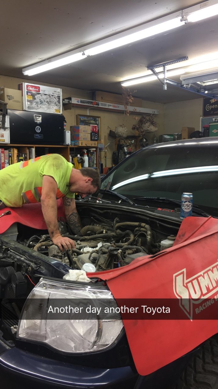

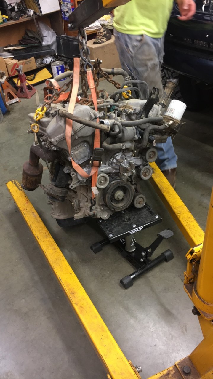

  5. Jun 18, 2018 at 9:38 PM
    #2565
    buckmaster243
    buckmaster243 I don’t know what to do with my hands
    Sep 21, 2014
    #138821
    1,819
    Buck
    Washington
    2013 DCLB, 2023 4runner
    How do you like your third gen? Having all those shifting problems everyone complains about or are most third genners just bitchers?
    Helped tear out a 4.0l tonight. Took the two of us about 3.5 hours with a dinner break in the middle of it.
    4D6CAD68-A62F-4F5B-80CA-7F5E987A1C5F.jpg 42081F67-C508-40E0-8B32-3104348094CB.jpg

  7. Jun 18, 2018 at 10:04 PM
    #2567
    buckmaster243
    Sep 21, 2014
    #138821
    1,819
    Buck
    Washington
    Haha that’s all he needs I’m sure. It’s got a blown head gasket, so just a fix and throw it back in. I guess it’s common on the 05-06s.
    That’s good to hear. I’d hate to see the tacomas going downhill. I’d like to test drive one and see how it did. Especially with a load behind it.
    Sperrunner[QUOTED] likes this.

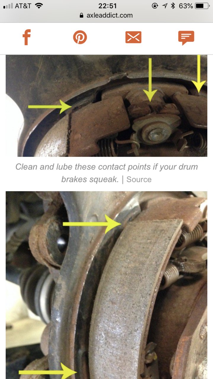

  9. Jun 18, 2018 at 10:45 PM
    #2569
    BartMaster1234
    Aug 21, 2016
    #195197
    45,886
    Tyler
    Pittsburgh, Pennsylvania
    Flux Capacitor
    Who's done drum brakes before?
    The drum brakes on my truck are fine, but my buddy with the '94 Grand Cherokee has had this terrible squealing noise coming from the rear whenever you hit the brakes. I believe the drum brakes are original to the car, there is no record of them ever being replaced.
    Would worn brake shoes be causing that squealing? Or maybe it's a spring or something as a part of the drum assembly?
    Originally I thought it was a seized caliper, but they appear fine and replacing the rotors or pads didn't do anything.

  11. Jun 18, 2018 at 10:50 PM
    #2571
    Sperrunner
    Sperrunner UA342
    Feb 23, 2018
    #245334
    50,666
    Miguel
    El Cerrito, Ca
    2023 Ford F250
    Its the company truck
    The ahow backing plate might be rubbing and need to be lubbed
  12. Jun 18, 2018 at 10:50 PM
    #2572
    BartMaster1234
    Aug 21, 2016
    #195197
    45,886
    Tyler
    Flux Capacitor
    I had a feeling it's some seized springs maybe. Could be rust too.
    Like my truck, the Jeep has never been off-road so I don't think there's any debris or anything in there. Who knows - I'll tell him to order up some new hardware, shoes, and drums and replace them.
  13. Jun 18, 2018 at 10:51 PM

  15. Jun 18, 2018 at 10:54 PM
    #2575
    Sperrunner
    Sperrunner UA342
    Feb 23, 2018
    #245334
    50,666
    Miguel
    El Cerrito, Ca
    2023 Ford F250
    I found a kinda helpful photo of the spots to lube (not a jeep, just a picture of drum breaks) but like @Speedytech7 said the springs might be bad or parts have rusted inside.
  16. Jun 18, 2018 at 10:55 PM

  18. Jun 18, 2018 at 10:56 PM
    #2578
    Sperrunner
    Sperrunner UA342
    Feb 23, 2018
    #245334
    50,666
    Miguel
    El Cerrito, Ca
    2023 Ford F250
    I would pull the drum and if everything looks fine just lube it, if that doesn’t help you have a different problem
  19. Jun 18, 2018 at 10:56 PM

    I think they make “drum break lube” idk how that differs from normal break lube though
