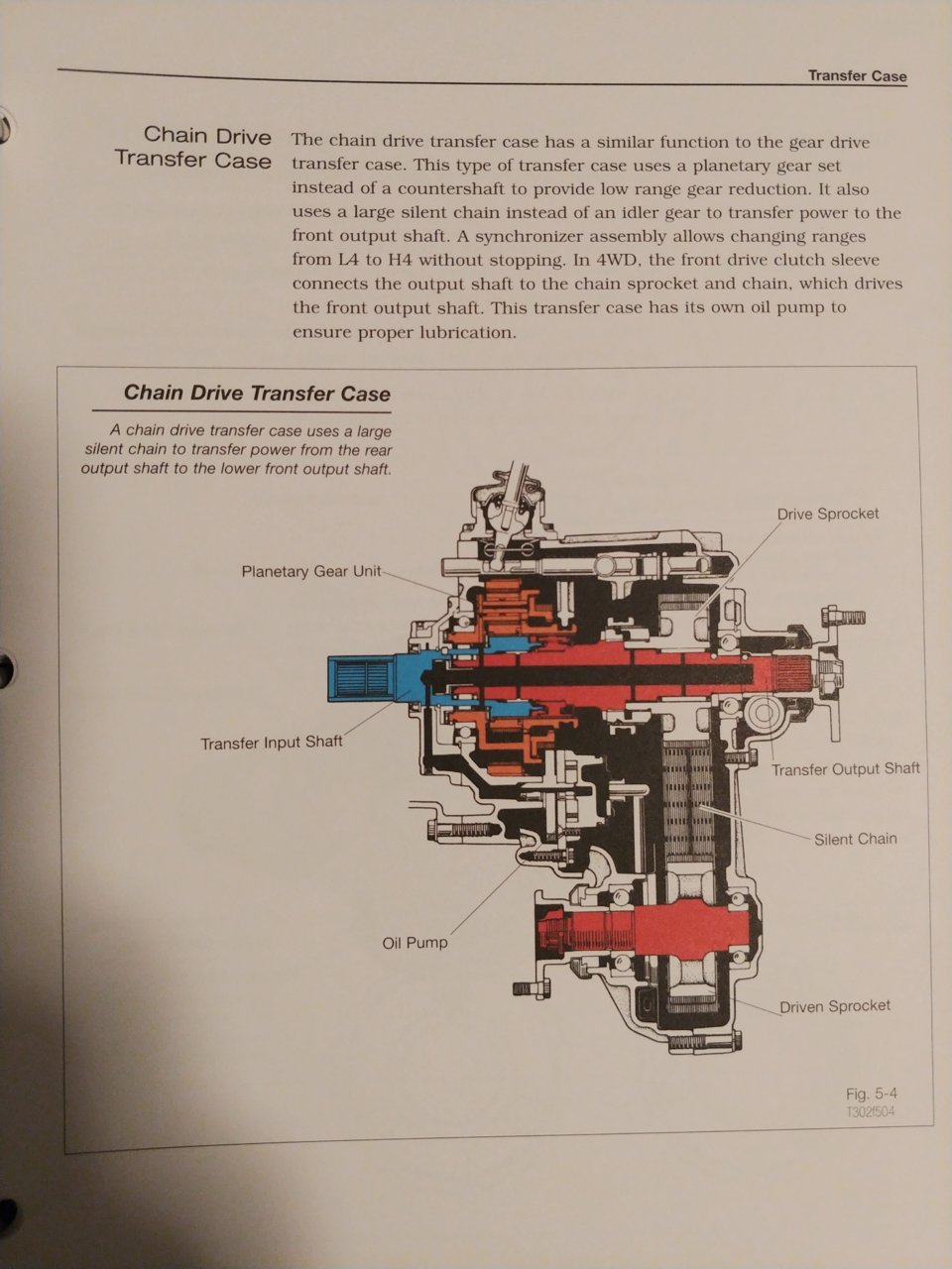

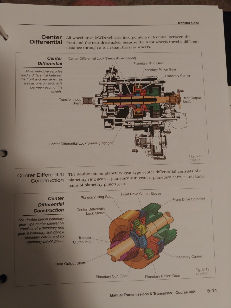

    I have the Toyota teaching guide for tcases and transmissions, so no opinion here. In both the AWD case and the 2WD capable cases if the front doesn't have add (why would awd anyway but it's important to explain) the chain is always turning, no matter what a chain is driven, that part of the design is completely unchanged. Manual hub vehicles locked in, spin the chain, as long as the truck is moving the internal oil pump is driven. There is no harm in running a normal t case with a non add front. It's actually a popular mod on here for 2nd gens so people don't break add stubs or have actuator failures hinder them.
    Unless you just want to have an extra failure point or you have some weird urge to swap differentials, I don't see any reason you'd need to. You currently have the most stout setup. :)

    That's the best information I have gotten from anyone yet! Thank you @Speedytech7!! I just wish you would have provided that before I bought the ADD diff. BUT, now I have a spare front diff that all I need to do is swap the ADD tube out on for the same, full-time tube my 4R already has. This will make it easy sending it out for re-gear and front locker. Basically zero down time involved that way.

    How does that apply to flat towing a vehicle? I've always assumed that a t-case in neutral isn't spinning the oil pump.

    It isn't, when you decouple the rear output shaft you get no tcase oiling, you have to leave it in 2wd and leave the manual trans in neutral, which means it gets no splash lubing because the counter shaft isn't spinning.... Soo now you know why flat towing is not possible. Thanks for attending my TED Talk

    Cool. So drop the driveshaft, always.
    Thanks for the confirmation!
