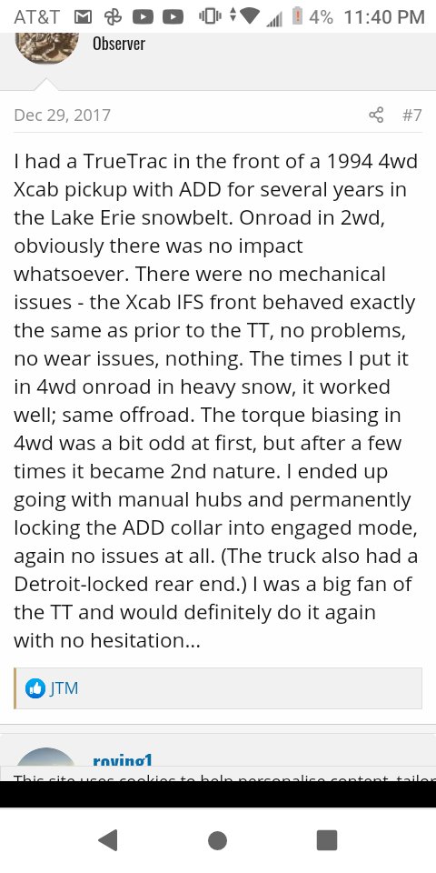

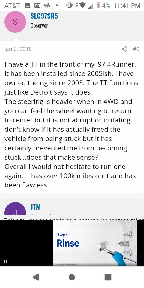

    That seems to be the theory
    But...
    I think I'll take that risk, the theory does make sense but a couple dudes on a single thread is enough to sway me the same way a half mile drive is enough to convince me to buy a vehicle

    Hell give it a shot, I wouldn't want that loading on mine, but you are staying with tiny tires by the sounds, so it probably won't be a huge deal with the wear. It would bother me having to load it up to turn and having it slide to distribute the load would be unfavorable. Would actually be scary going down a switchback in loose conditions. The front would want to slide. But, that said, I'd like to watch someone else fuck around so take vids if you ever actually use it.
