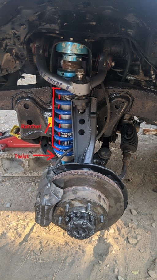

    Just so I understand, you have the top 3 bolts in at the coil buckets but you cant turn the lower eyelets to line up the miss alinement spacers to the lower control arms. If this is the case take 2 tie downs one on each side of the coil. Loop them around the coil and ratchet down. This will take the pressure off the lower coil seat and the eyelet. You "should be able to turn the eyelet and shaft at this point.

    Yeah I'm going to try that this coming Tuesday.
    I have more tools in my storage and apartment, and was working only with the tools I carry in the truck.
    Relieving tension the way you mentioned is the ticket, not to mention getting a longer screw driver for more leverage at the bottom

    Just funny how the Tacoma Fox went in with a breeze, and the 4R Kings were beating me up.
    Think my back and rushing to get errands done got the best of me that's all.

    Yeah forgot to mention that I think I used a 16 inch screwdriver also

    @Kwikvette This will help with any alignment issues
