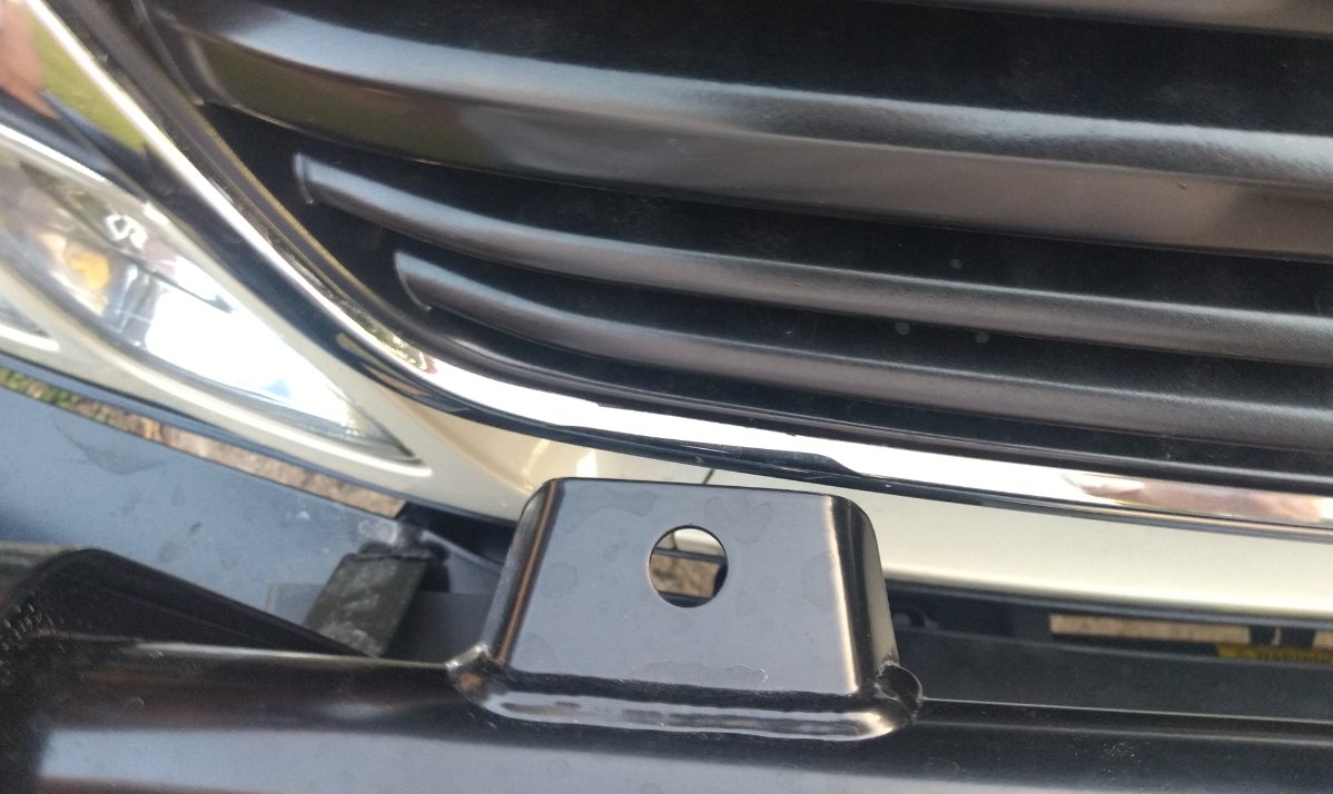

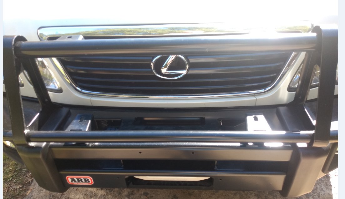

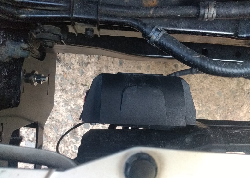

    Picture of the ARB bumper installation. The bumper is for a 2003-2007 model Land Cruiser. The Land Cruiser hoods do not have the grill attached.
    A 1999 model LX470 will bump into the bull bar when opening the hood with a 2003-2007 ARB bumper.
    The choices are to remove and relocate the light tabs or modify the grill mount so the bottom of the grill points in at a different pitch.
    We decided to modify the grill instead of moving the light/antenna tabs. You can see how the grill is slanted in 3/4 of an inch across the bottom.
    I need to get a battery cable that is capable of running a lot of accessories.
    Also, I need to figure out how to wind up the winch while it pulls in a 1,000 pounds weight. My neighbor says to tie it up to a tree, then put the truck in reverse and let it idle. Then use the winch to roll up the cable while pulling the truck toward the tree.
    The winch owner's manual says to unwind and rewind the cable once a month to keep the self-lubricating part working.

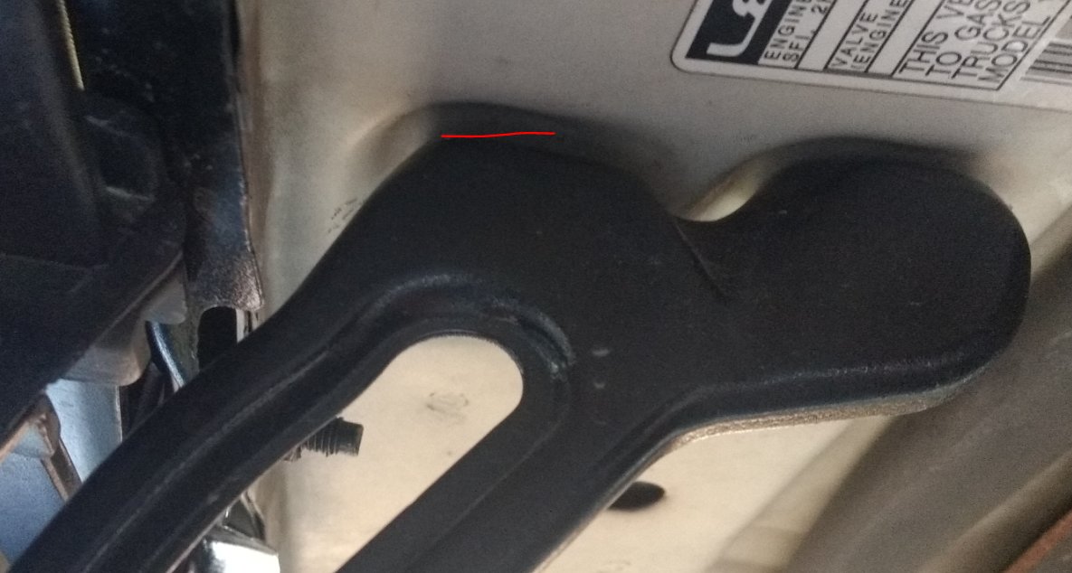

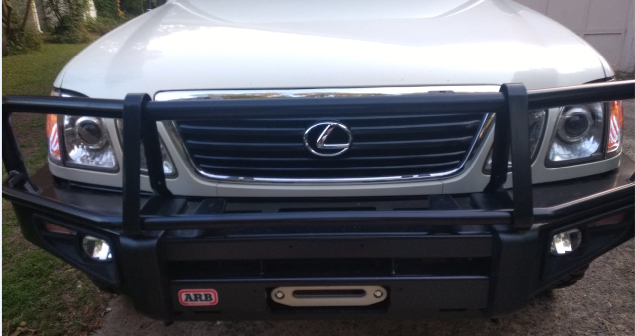

    Now it clears the light tabs. It doesn't need a lot of room.

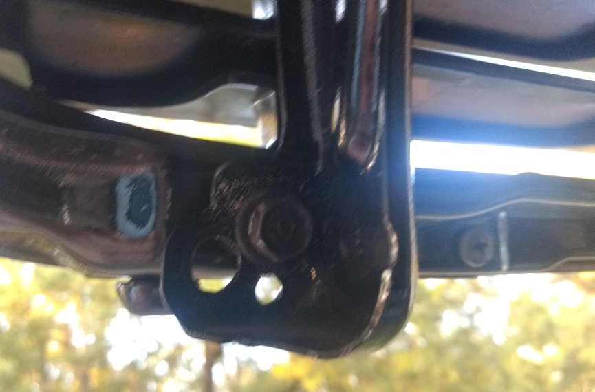

    Drill an additional hole to shift the grill mounting pitch.
    Added a shim under the front mounting bolt location to shift the grill inward.

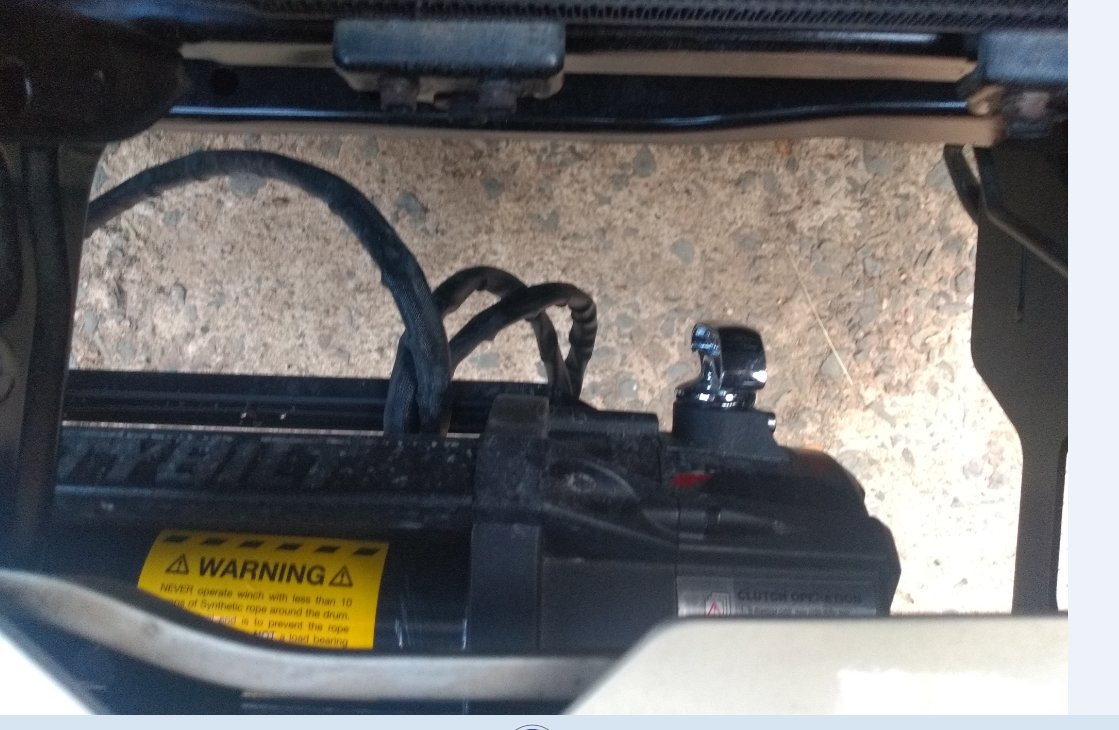

    The winch is mounted feet facing out the front.
    Shifted the control box to the side. I might move this up behind the grill after I see how well it works in this location.
    The next step will be to wind up the synthetic cable. I understand it needs to pull 1,000 lbs to properly wrap the synthetic rops.
