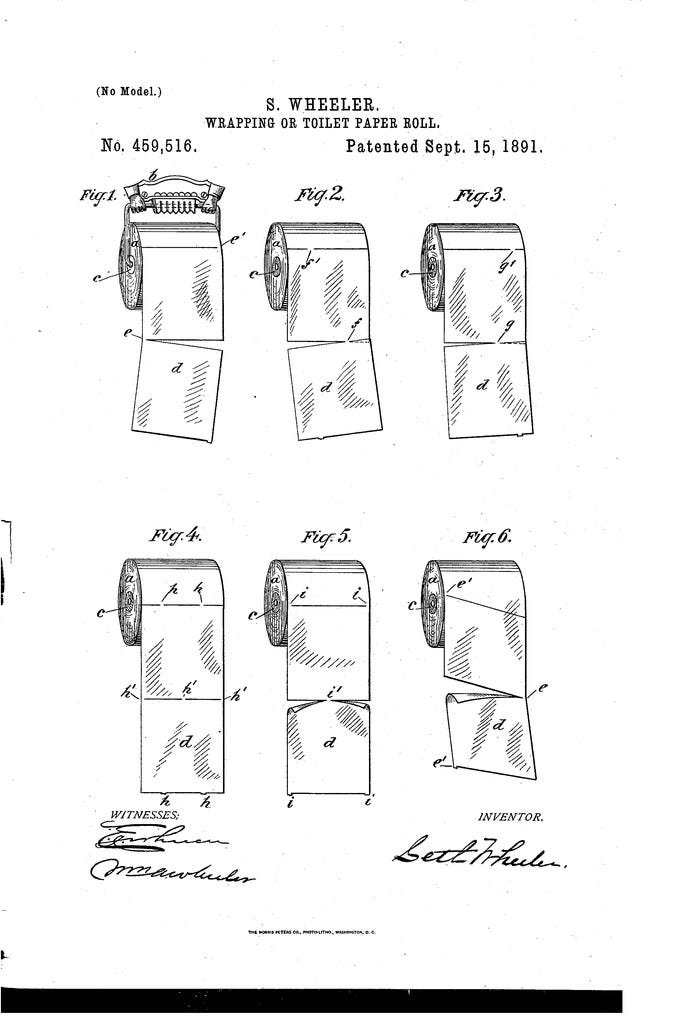

    The patent for toilet paper show the correct orientation of the roll and therefore, everything else is incorrect.
