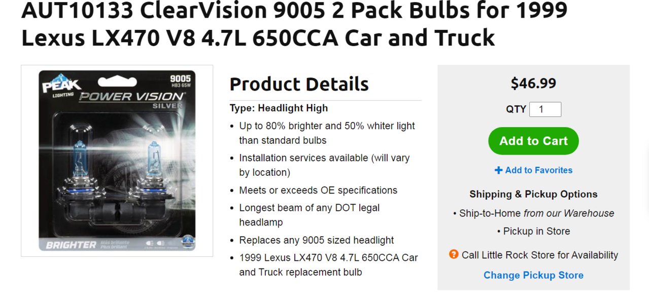

    Since I may be going to batteries plus this weekend, any experience with this type of light bulb?

    No sir, just look like one of those lightly tinted ones to help bring it closer to 5000k color temp

    dont waste your money. for 9005 do the 9011 bulb mod. trim a tab and enjoy double brightness plug in bulbs with longer life.
    for 9006 the bulb is 9012
    xtremewlr and CS_AR[QUOTED] like this.

    Thanks for the tip. The 470 DRL uses a 1003 Bulb. Only one headlight bulb is listed.

    i've got the 9012 low beams and 9011 high beams in the corolla... by far the brightest headlights ive ever had in a car. they even top the rental corolla i had with with fancy OEM LED "im blinding everyone im facing" lights
