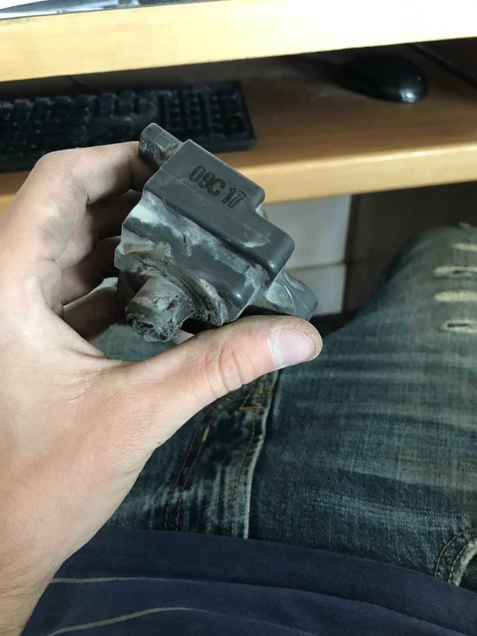

    Yikes, new coil and I'm guessing plug time as well haha

    Hopefully your head still has threads

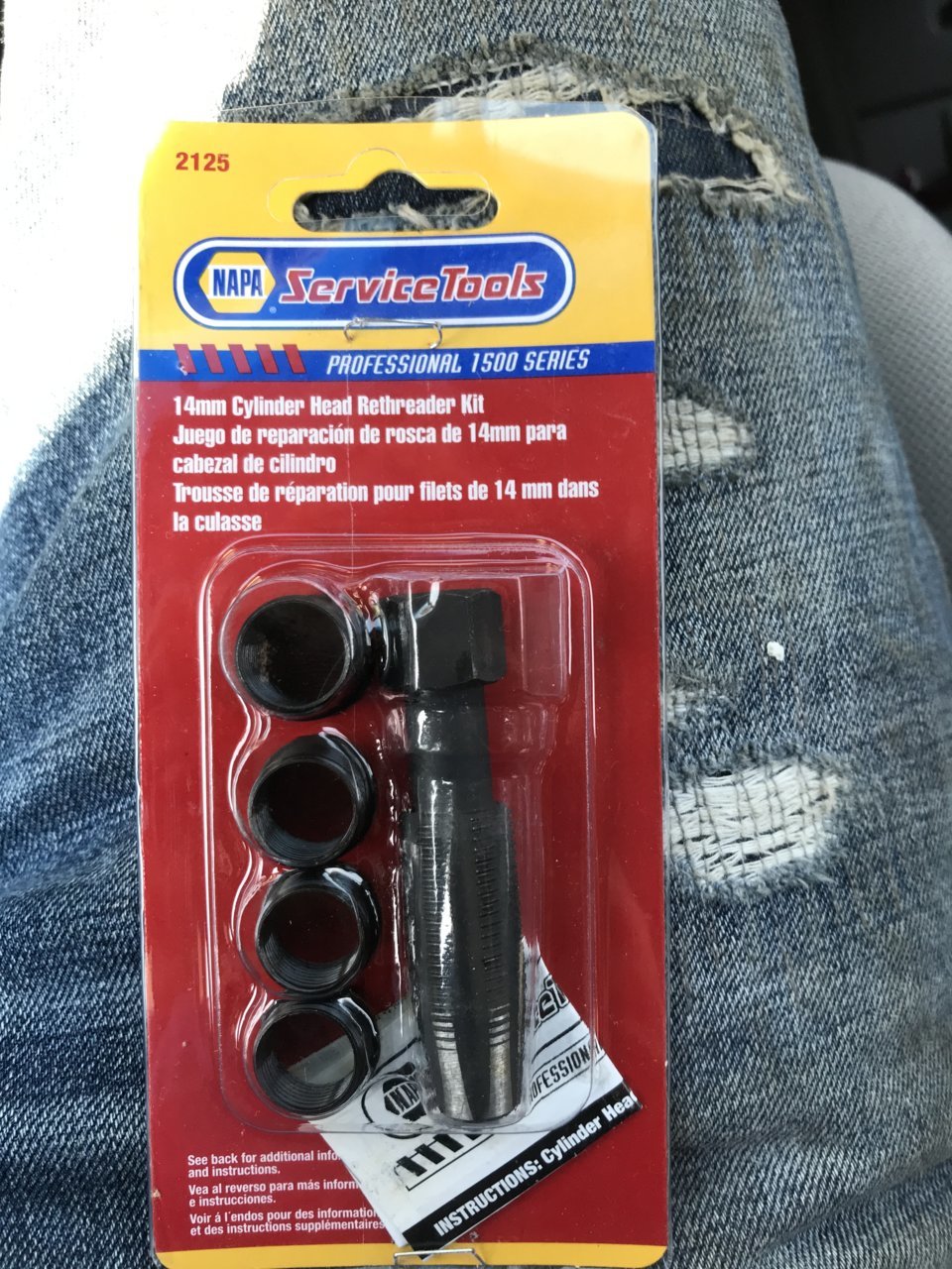

    Well, threads are gone, gonna try a helicoil or whatever they’re called I think

    Make sure and crank the engine without the plug after you break the end off the helicoil to shoot the tail out the hole so it doesn't get caught and scar up the cyl
