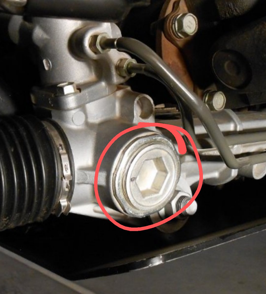

    Backed off the rack adjustment nut to 26 ft/lbs but steering still feels tighter than I'm used to... But considering the nut was finger loose before I guess I'm just used to the steering being way too loose. Crazy how sensitive that thing is

    Just mark the rack/bolt and see if it moves again from there.

    Yup used a paint pen on it, at only 26ftlbs I wouldn't be surprised if it did

    Yeah that's how mine is being. I've heard if they are too tight it will ruin the rack too so I definitely don't want that. But hopefully it holds on the right torque spec

    Put a dab of RTV on the edge where the threads are and the body of the rack. Should help keep it set in place. We do that with various motorcycle bolts on street bikes at the race track that need to stay put, like the oil drain bolt.

    It's this wonky thing right here, gotta jam a fat 24mm allen key in it to adjust it lol.
    No threads to mess with but I could put some RTV on the outside to dissuade it from wanting to turn itself

    Yeah, that's what I meant. Couple dabs on each side will help prevent it from backing out on it's own.

    Better than too tight from what I've read, mine was leaking some PS fluid though from being too loose which is how I caught it

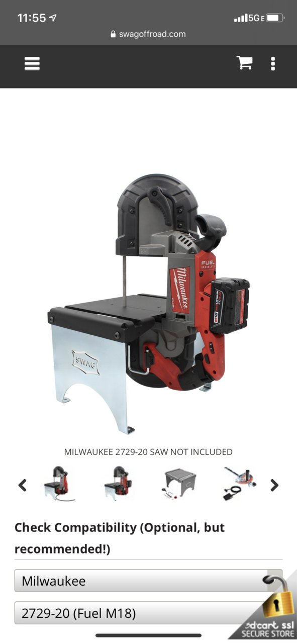

    Been staring at it for awhile and finally decided to buy one. Now im just finding any Excuse to cut things with it.
    will probably buy the swag table for it soon too

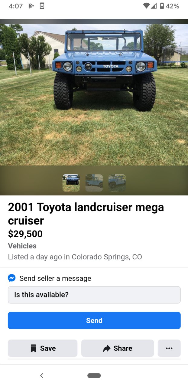

    Toyota Mega Cruiser for sale in CO
    Get it @Wulf

    125$ for it

    The corded version of it you can also get a few options For a little more $$ like a foot pedal to turn it on and off.

    Yeah that Milwaukee cut off table is $$$.
    dont have a need for it either. But the swag table would be good for my little home shop, cut small things with it
