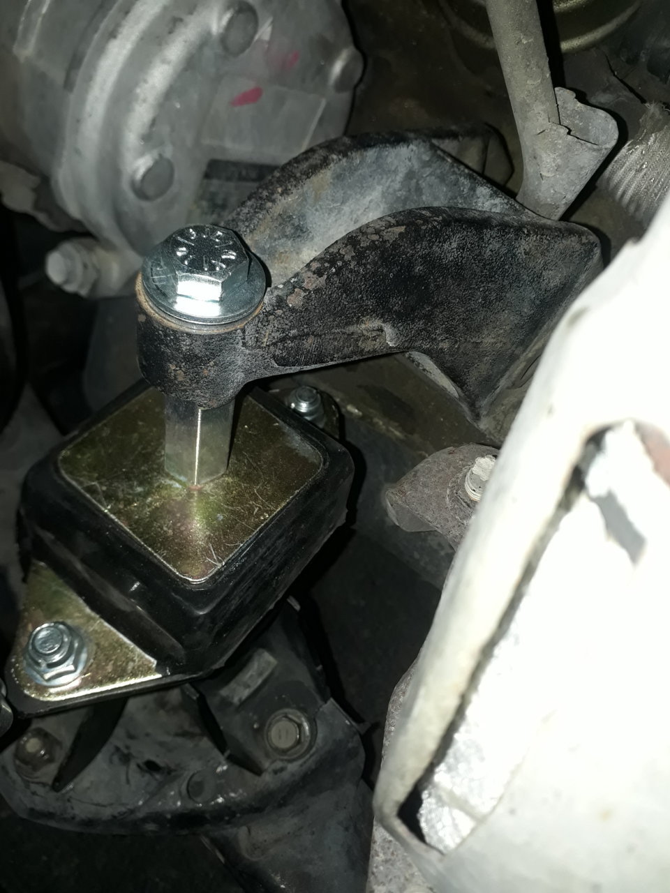

    Its a family car meant to have no noise vibration or harshness thus has soft af mounts
    when you start rallying it, doing burnouts and other things you do to a car you dont care about the soft rubber gives out
    Yes they were from a parts store, and did the exact same thing in the exact same time as the original ones after i got the car

    Thought people like you just filled them with polyurethane and shit
  6. Oct 13, 2020 at 8:51 PM
    Running Board Man
    Running Board Man Well-Known Member
    Feb 19, 2017
    #211024
    8,812
    Not possible with its design

    Honestly works the best, if it's a tough mount to make solid or an unbalanced engine at least. Drill holes in the old rubber mounts and fill with the tubes of poly caulk, or the more DIY stuff you make and pour (takes longer)

    Og camry motor mount cut down with a plate welded to it that a jeep mount bolts to
    The stud that pokes up has a coupler nut threaded onto it that a bolt goes into

    That's a creative torque mount

    The amc 4.2 energy suspention one was $36
    I should have just gotten the $10 rubber one i almost dont like how stiff the poly is
