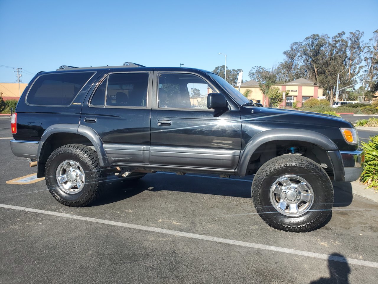

    Truck is clean

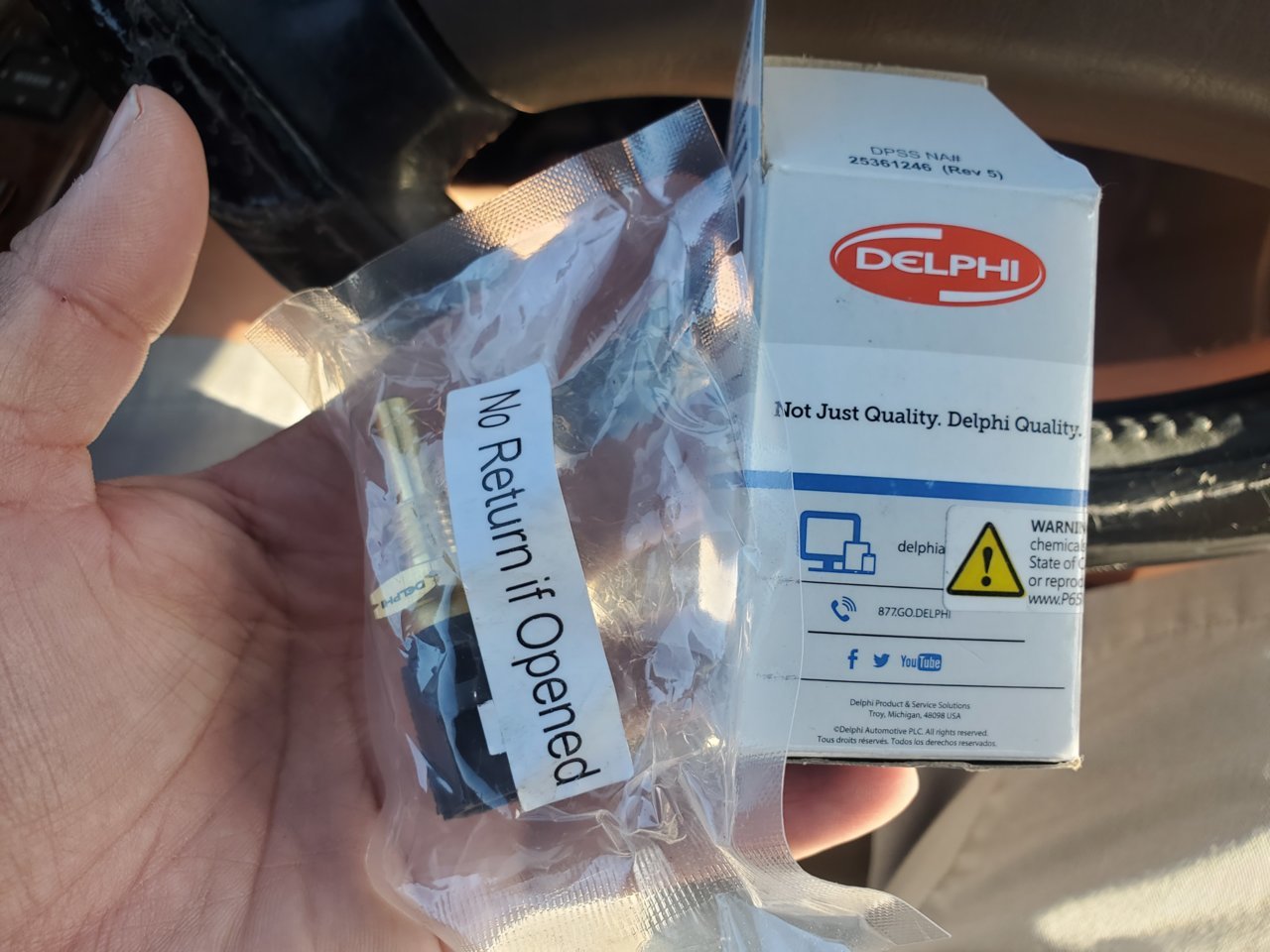

    Sensor is purchased

    On second thought....waiting again since my truck won't fire up

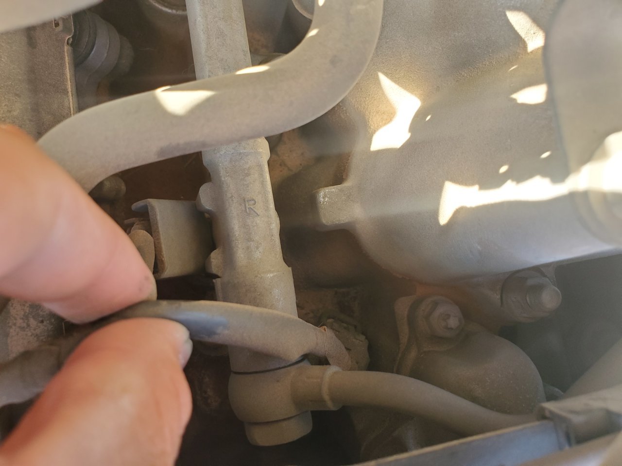

    Just went back and read through the posts...where's the coolant temp sensor located on the t4r? I wonder if all that Moab dust got to it

    Same as the Tacoma.
    Just offset from the passenger side fuel rail.
    Need to undo the clamp on the upper radiator hose to get the little clearance needed to pull back the plastic timing belt cover.
    After that, undo the bolt on the front of the fuel rail to be able to get the deep socket on top of the sensor.
