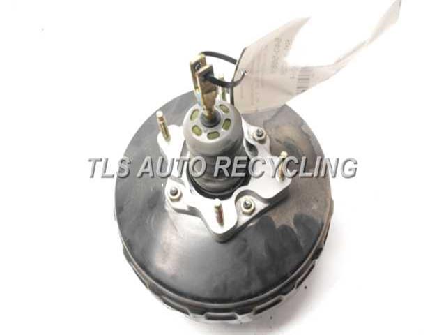

    Who makes this adapter you speak of? Which way did you go?

    It's less Tacoma and more mod
    It's made by Toyota, should be available new or used. Instead of casting a master that fits, they just rotate the booster with this bolt on adapter. I dunno why
    I'm going with the 80 master, but for 01-04 models this bracket is the better option.

    Are you sure you even need to fuck with the booster? I have tundra brakes upfront and FJ80 rear disc and use the stock 02 master and booster and it stops great. I can lock up my 37s (barely).
    I don't have to fuck with it because I have a dual diaphragm booster already that the FZJ80 booster bolts right up to. I won't use a drum master on rear discs though, residual valves make it feel wrong. I don't even like Tacomas with tundra brakes that don't change to an appropriate master, feels like sponge cake.

    I still don’t understand what you’re talking about (unless it’s that drastic of a difference with the dual booster) the tundra uses the exact same booster and master as the 01-04 tacos. Unless the tundra had VSC

    it literally doesn’t work with a dual booster and master. It feels like crap. I think the tundra brakes on tacos feel like crap too but that’s just an issue of Toyota using the same parts to save money

    I put a residual valve on and threw it out immediately as all it did was cause the brakes to drag, that's what I get for listening to the internet.

    I just hated drum brakes, hence the 80 axle! Now it's awesome with the strength upgrade. I recommend to evreyone price an entire 80FF rear axle vs a disc brake kit, in my case I saved $300 over the cost of a kit. I did run factory front brakes again with 37s when I had my 15s and honestly didn't notice much of a difference when I switched back to the tundras.
