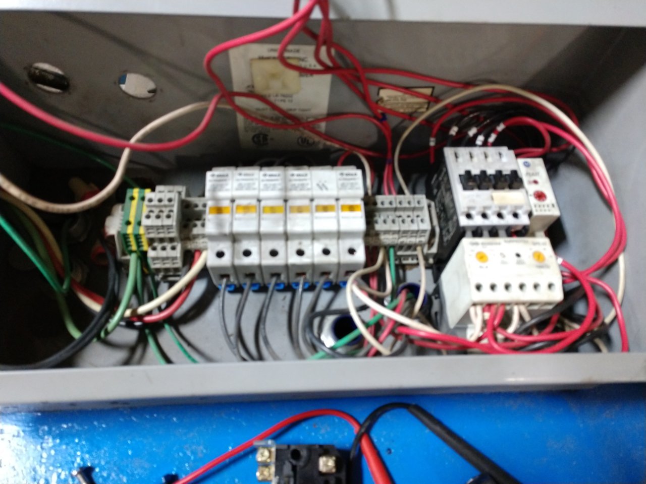

    Or a schematic?
    Coil on the motor starter wasnt latching.
    Changed the contactor= nope
    Changed the stupid A-B push/pull button= Nope
    Unwired the timer that makes it drop out after 4 mins= Nope
    Finally I got it figured out when I unwired the NC contacts on the overload part of the contactor. Have a new one on the way, but a schematic wouldve helped me get there a lot quicker.

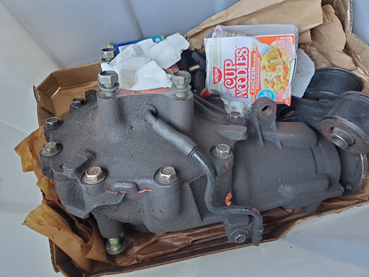

    Sciatica and Moab slowed me down from getting the front diff ready to send out.
    To be honest, I'm not looking forward to boxing it up and sending the fucker out (my biggest reason for not jumping on it right away).
    It's in one of those Craftsman or Rubbermaid bins...

    Pfffft, easier fix: just tape down the "Black button" on the contactor e7dfc5ecbb991b57f720dec4e61a554a.jpg

    Atleast it isnt all black wire even for the grounds. Because ive seen that

    That shit bugs me to no end! I have to OEM customers that request all black wires for both power and control circuits :mad: I cringe everytime I have to build one of their orders
