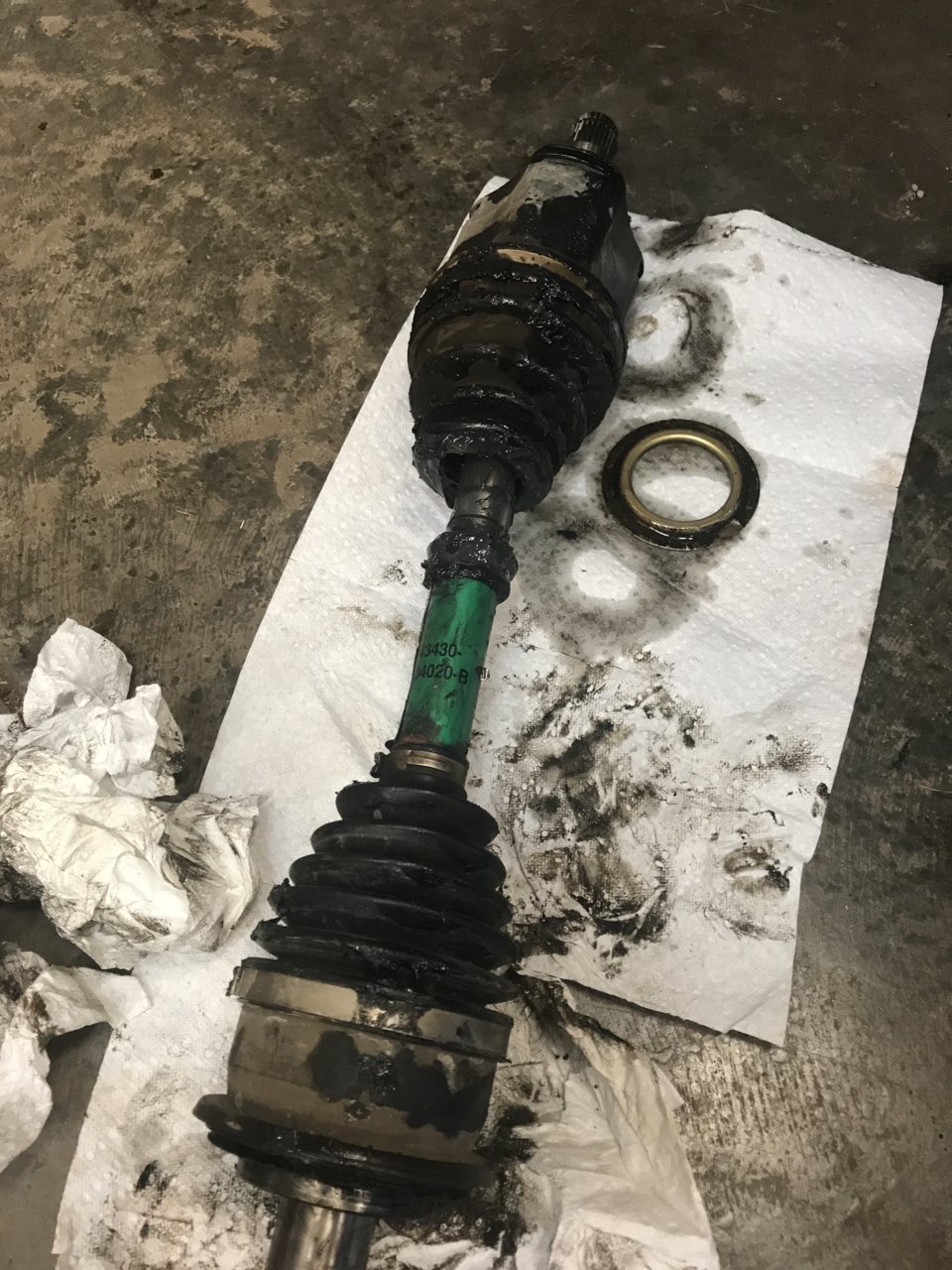

    Any tips for prying the CV out of the diff?

    Find the lip on the cv and pry with a bar, might take a bit of messing around it get it.
    Someone with more experience will come in a second if they haven’t already.

    Yeah that's what I'm trying, it's stubborn haha.. pry bar slipped and slammed by arm into the truck :anonymous:

    Did you take the skid plate off? I think it’s an easier angle to get at from underneath

    Big prybar. That’s what I did.
    And to push it back in, use he CV as a slide hammer by the joint. Grab the outer boot and slam it forward.

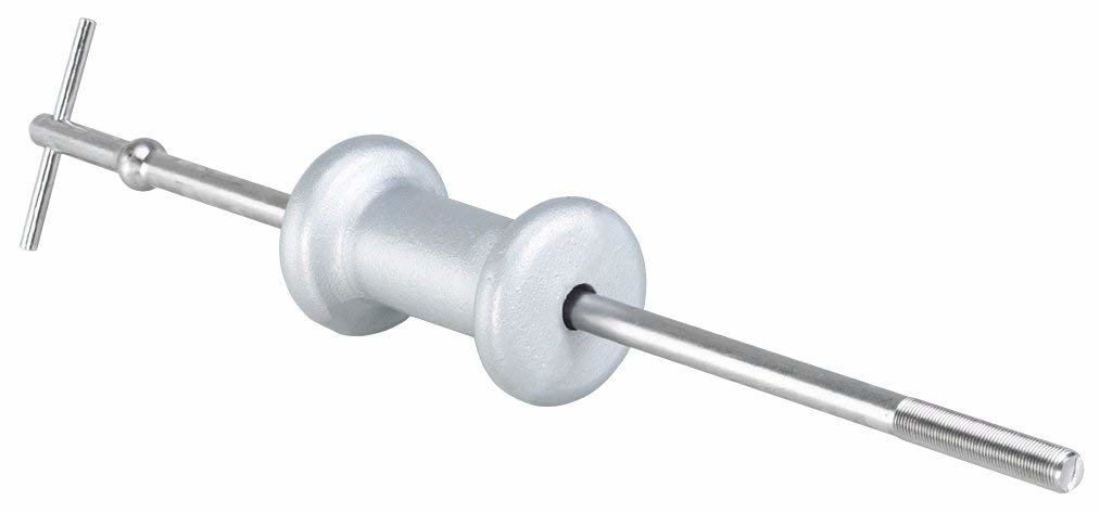

    I saw a guy make this thing that goes behind the cv then use a slide hammer to take it off

    Wtf’s a slide hammer

    Got it out of the diff, wasn't that bad. Can't seem to snake it out though, so you have to pull the sway bar link off to make room?

    You've never seen a slide hammer before? Such a useful tool for seals, CV's, body work, etc.
