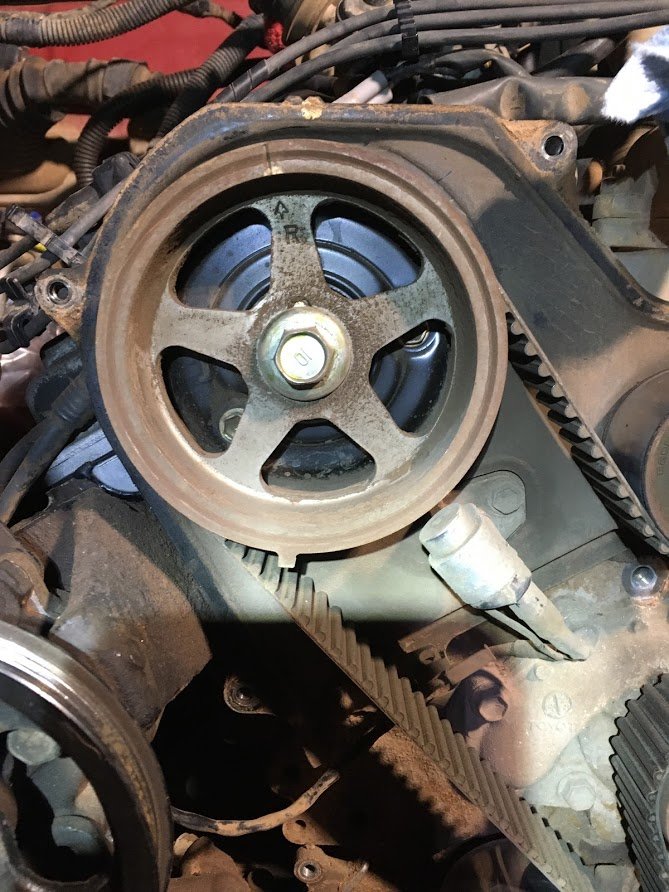

    If I'm reading the fsm and Adventure Taco's timing belt guide right both camshaft pulleys and crankshaft timing gear notches should align to set cylinder #1 to TDC. So it's looking like the R camshaft pulley is a bit off? This is how the truck currently sits with the old tensioner and belt untouched. The notches are all perfect on the L pulley and crankshaft timing gear.

    if the crank mark and the left mark are lined up, that bank is a tooth off

    Interesting. So the truck got put up for auction in the mid 2000s after someone put almost 200K on it. So this gates timing belt is this motors second belt in ~300K miles.

    they can
    skip a tooth under heavy load if their old and stretched.
