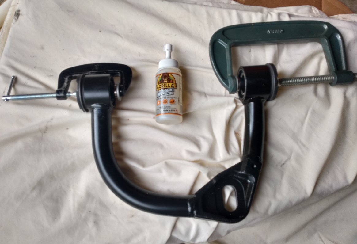

    Nice. I like SPC. Some old guy on Mud gave me a tip about scrubbing the paint off where the BJ nut torques up to the arm. He said the paint will eventually cave under pressure and allow the nut to work loose. I gave it a try. So far no loose upper ball joints. Note that I'm not worried about rust.
    Per directions, the inner washers are supposed to be stuck to the inner bushing metal sleeve using grease. This may have been a 100 thing. After 2 or 3 tries where the washers would fall out while attempting installation with grease, I gave up. I said to hell with it and used some Gorilla glue with c-clamps overnight to glue the washers in place. After that, it was a piece of cake.

    If you have trouble getting the washers to stick, you are not alone. It's just one of those things that few people talk about. It might be easier to install them on a Taco. The arm needs to slide into a channel on the 100 and that's where the problem starts.
