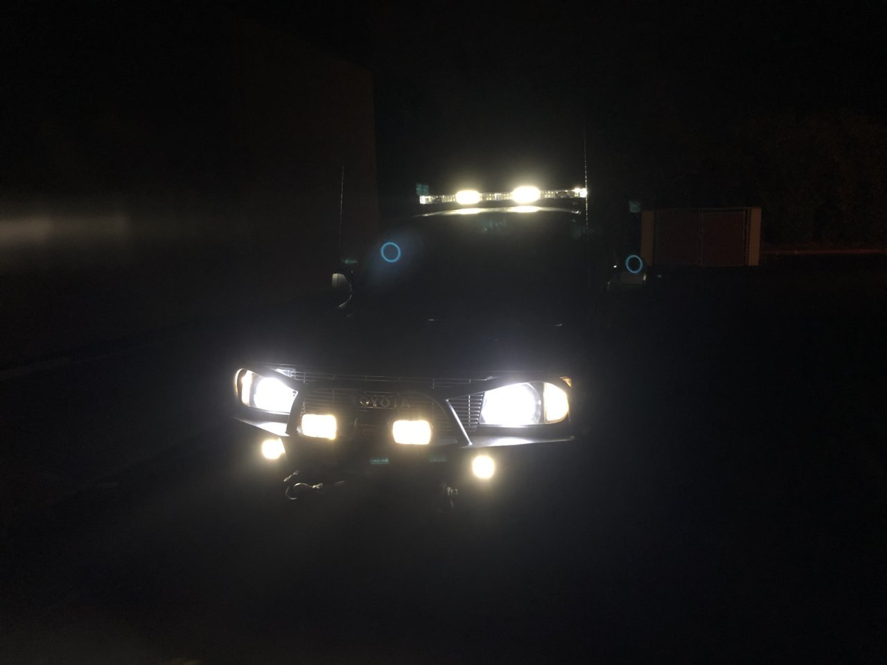

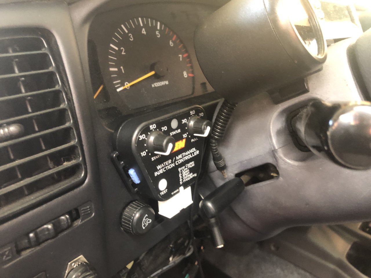

    Haha thanks. I spent all day working on finishing hooking up up wrecker lightbar and the methanol injection.
    Need to get it tuned soon

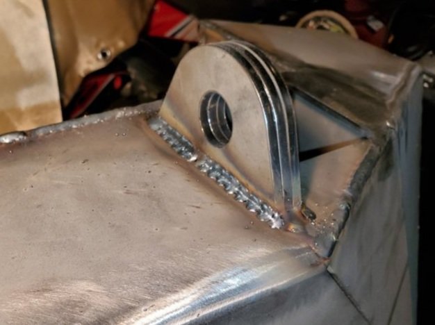

    I didn't weld the hole, just the outside diameter part. You want to leave the hole alone so it still fits the shackle.
    I only ground down the outside welds. Don't care about the inside, no one will see them unless they are crawling under the truck. Doing the same with the front Coastal I'm doing on the 4Runner right now.

    Thanks, I wasn't sure if I should weld and then drill it. Did you end up grinding the welds on the inside of the bumper? I'm debating leaving them since they won't be seen. Was curious what others do.

    Edited my post to answer that while you were posting. Nope, leave the inside welds alone.

    I believe the concern is moisture getting between the plates and swelling them up with rust

    Not really a concern for me living in AZ. :notsure:
