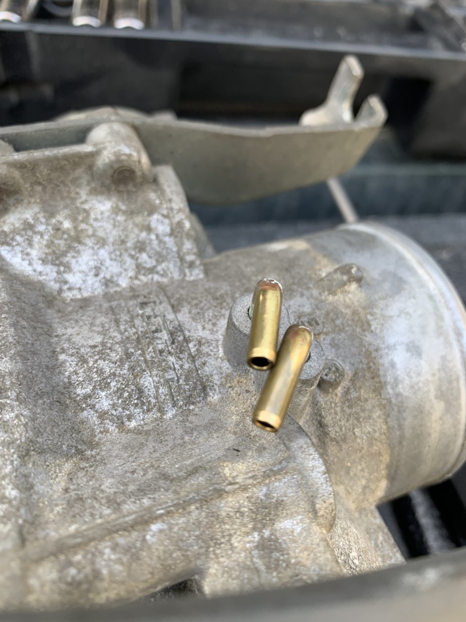

    Question you guys. I have 2 throttle bodies. My old one has these black caps, new one doesn’t, does it matter?
    can I take them off without breaking them and put them on the new one?

    they should slide off with a little effort. if you break one/both you can connect the two nipples with a short piece of vacuum hose or buy new caps

    thank you, swapping them now
    If you don’t mind me asking, what is their purpose?

    I don't know OTOH, if I had to guess they are for trucks with the EGR
    I've never seen a truck where they were hooked up to anything

    Unused vacuum ports. The black things are vacuum caps. You can either swap them, get new vacuum caps (any kind that fit) or connect them with a piece of vacuum hose per @Wulf.
