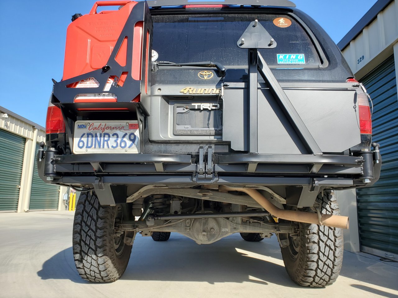

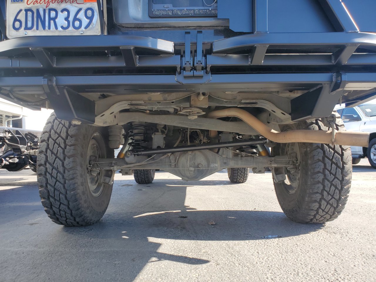

    Going to run a sway bar until I can get the Eimkeith PCK purchased and installed otherwise now my rear sway bar is the limiting factor in my rear suspension.
    Having undone the sway bar, and allowing the rear to droop completely, the 906 springs could've been taken out by hand, or even fall out if one side was pushed up causing the other end to droop more.
    With the 890's, they're so long, there's no chance of fall out.
    But seeing as how my panhard is still slightly angled, I still get that axle pull when the suspension works...
    @Speedytech7 just come to CA and set my shit right :rofl:
    Weld a PCK in for me and adjust my panhard bar once my lower links arrive.

    New 890 coils have more wraps -
    And to compare, the 906 coils -
    Brought up the rear another half inch but most importantly, replaced my other CV axle (driver)
    Here's the day when I drove to get my rear bumper and found my boot had torn -
    Only shitty part is I'll need to dig my passenger CV axle out since it's leaking at the seal possibly. Think that hit I took yesterday knocked it a bit or it was leaking and I never noticed.

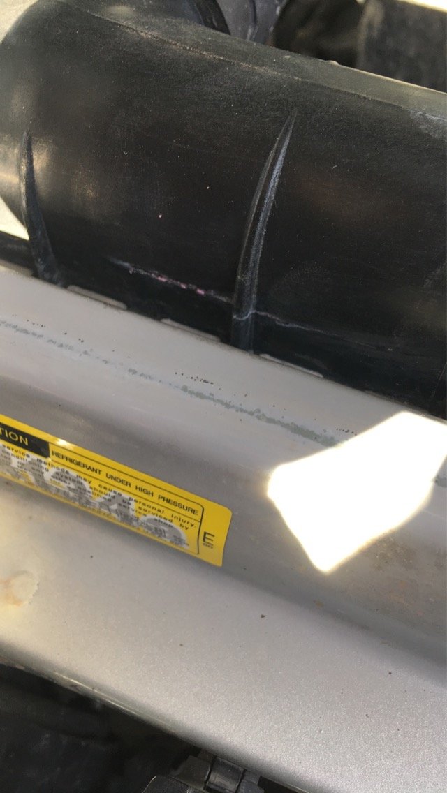

    Small crack on my factory radiator. I’ve been losing small amounts of coolant so glad I’m cleaning my engine bay and checking things. Now to decide on what radiator to replace it with. Can’t remember if someone said that Koyo 4Runner one would work on an 01-04 Taco hood. If so I might do that and run a separate trans cooler.
