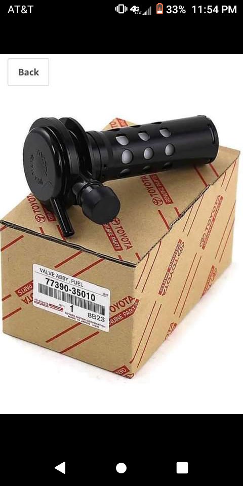

    A roll-over valve? Like a shut off valve? I didn’t know our trucks had that. I’ve only seen newer sedans with them.

    They might, but it won't be because of the cat. The cat isn't part of the evaporative emissions system, not even attached directly.

    I honestly didn't even know our trucks had a rollover valve.... And I rolled over before. Unless it was in the tank and not on the neck I'd have a hard time seeing how it could be a problem.

    Seems like an 01-04 thing, the evap and fuel system changed a lot in 2001.

    This guy?
    01/02 4 runners got it, if it's like the throttle bodies 03/04 tacomas got it

    Yeah looks like it.

    Fuck that part. Mine cracked right at the top and caused the truck to seep gas fumes on steep inclines ultimately leading to it not wanting to start on the trail...

    Part of me wishes I had the 03-04 evap system because it eliminates the charcoal can in the engine bay, but this sorta changes my mind.
