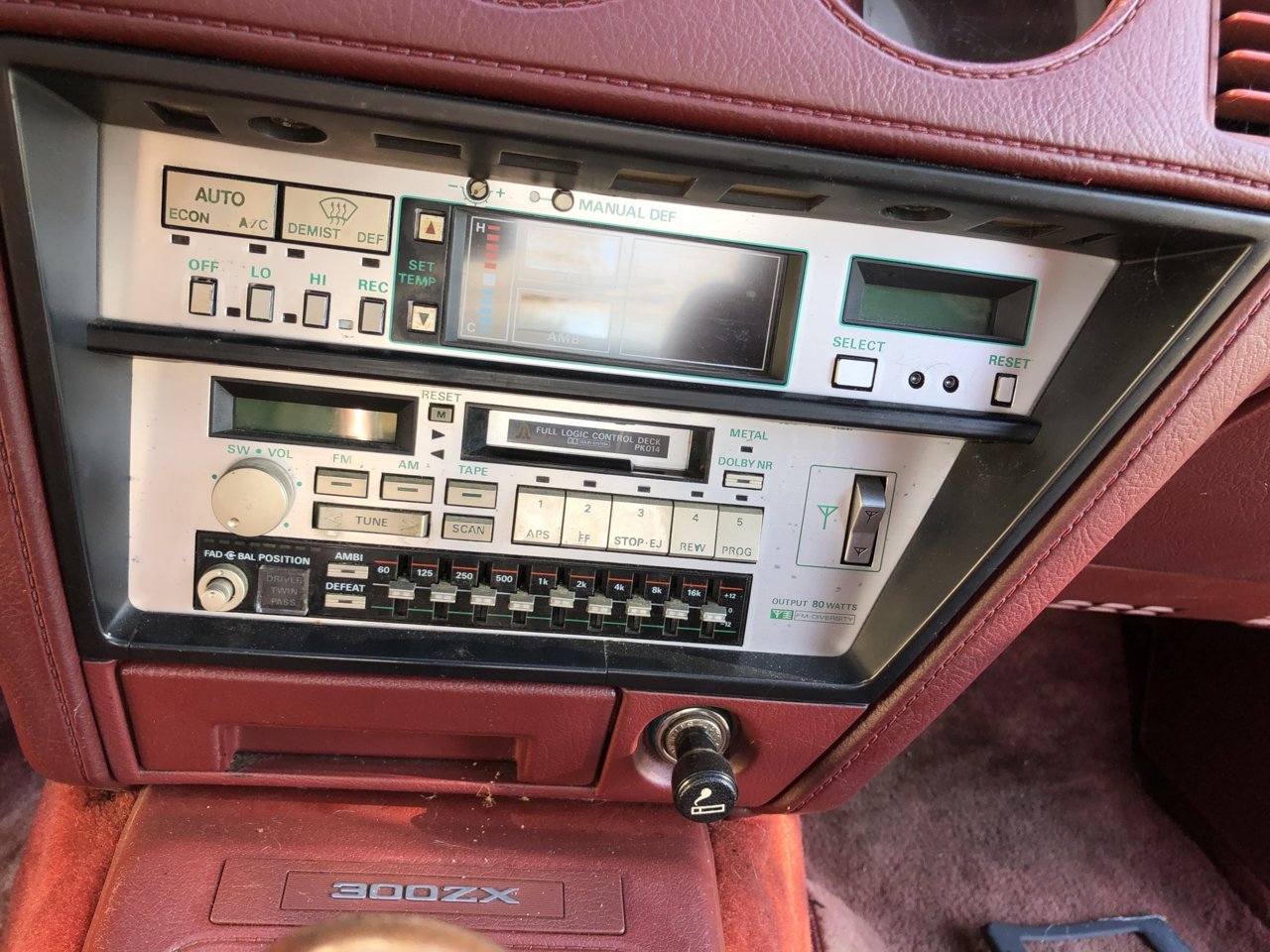

    I still have the factory Hitachi radio in my 300zx. I’m so hesitant to change it because it looks awesome, and if I put a modern one where it goes it would look tacky.
    Only one issue. The stock stereo is awful. I’m pretty sure the amp and radio need going through with new caps and everything because it sounds so bad.
    I really want to keep it. Totally completes the 80’s vibe.

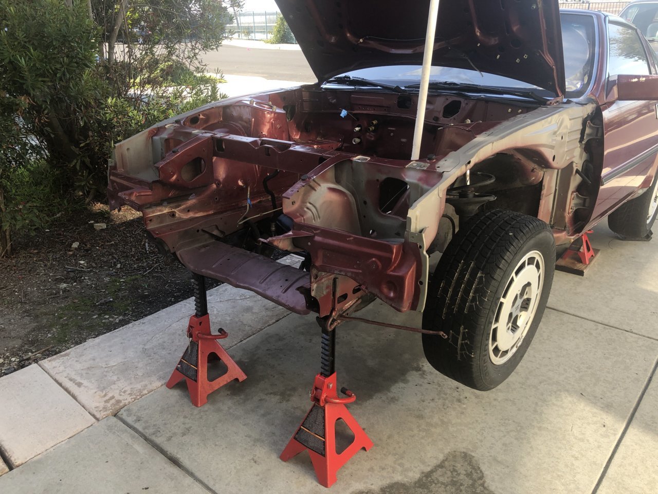

    Get another one!

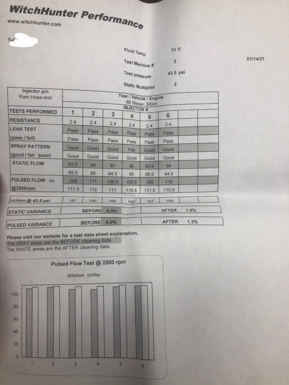

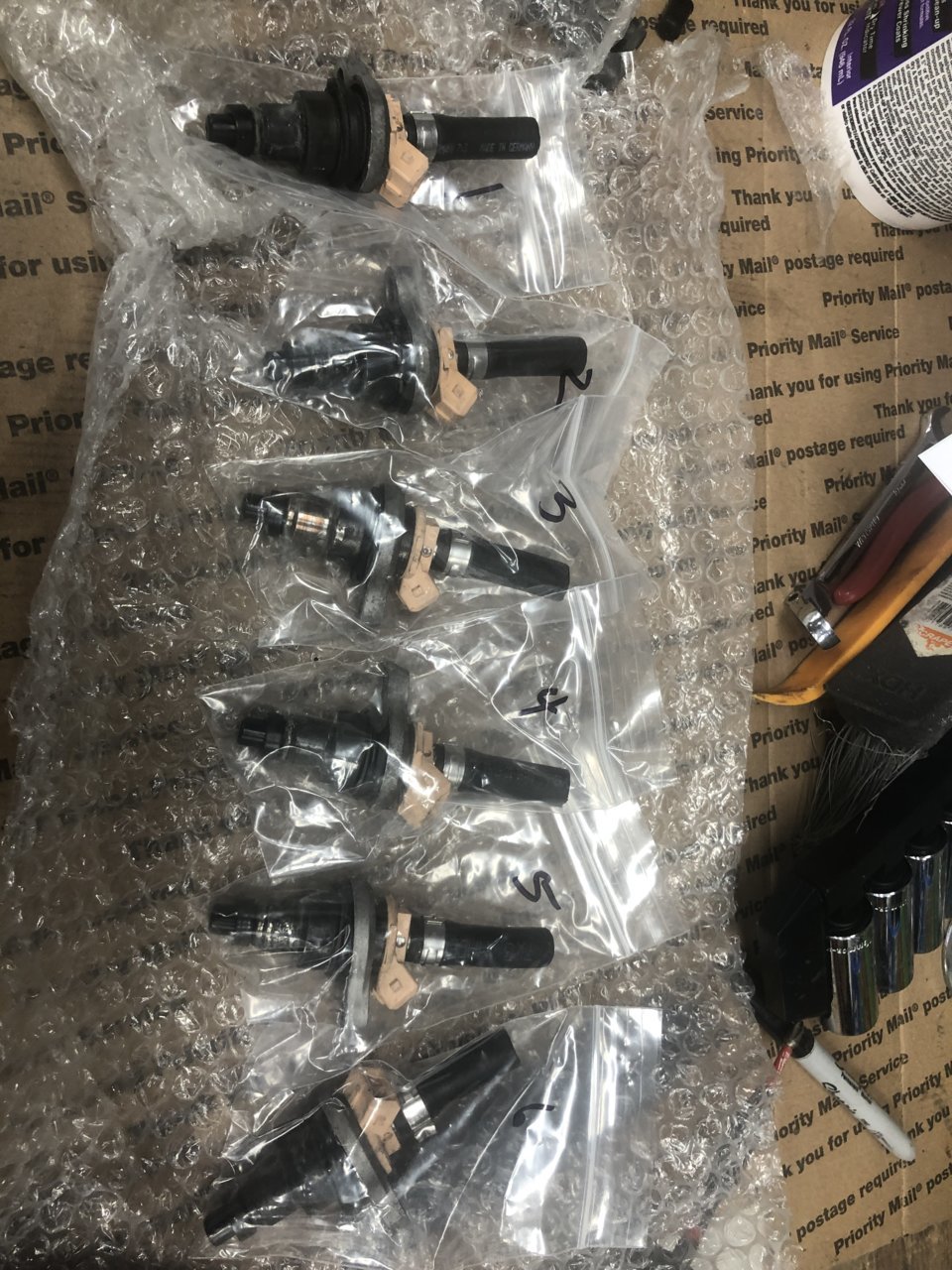

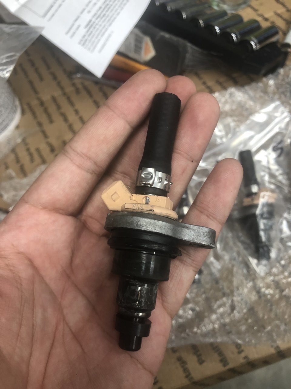

    I just got my fuel injectors clean and rebuilt and flow tested. PO replaced them at the dealer and only put less than 3,000 miles on them before it sat for years.
    4ED23555-E836-478E-9FBD-C2F1FCE9CC07.jpg 10D46120-EC49-4BA4-AA2C-83A316D3C24C.jpg 3C3B361C-26B6-4214-A4C2-D5A2E57B5437.jpg

    I bet it wouldn't be hard to open up and look. might be fun too, all that is probably through hole and easy to solder.

    That's pretty awesome, and a little intimidating.

    Don't you dare get rid of it! That's awesome, Rebuild it yourself

    I was thinking the same thing, should be easy enough to de pin and resolder new components. It would've been all hand made in the 80s anyway

    I’m on the fence because I really love it. But Bluetooth didn’t exist for another 25 years when this was made haha. I’ll see about re-capping it.

    They still sell tape adapters, does the tape deck work?

    So what you do is get one of those cassette tape adapters that were all the rage in the late 90s .. the ones that plug into an aux device

    I have one in there. Used to use it when the car still ran.
    Still sounds awful because the audio has to pass through the 34 year old electronics and 34 year old speakers haha. I’m gonna see if replacing the speakers will make a difference.
    The tape deck didn’t work but that’s expected for something this old. Old rubber belts.
