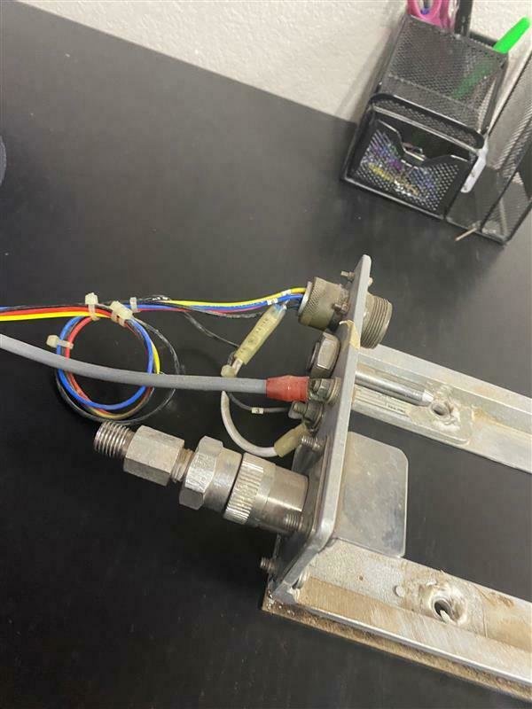

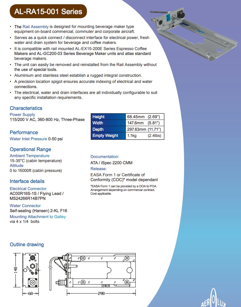

    It says right there on the spec sheet for the cable sled, plus that other coffee maker has an ID plate stating it takes that voltage.
    It's a weird voltage huh?

    It will, but it won't last and it won't get hot enough.
    400Hz frequency is getting into federally controlled components. Because 400Hz is commonly used in weapon systems

    Completely over looked that on the spec sheet lol
    The reason they do it is because a higher Hz rating means a smaller capacitance is required therefore allowing smaller components to handle it all. Smaller equals lighter which is what you want in an airplane I'd imagine

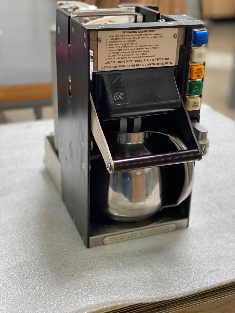

    here you go

    Sure, everything is "possible" but definitely not practical in this scenario. Essentially you would need a 120VAC 1phase 60hz input VFD that would spit out your 120VAC 3phase 400hz. I sell em
    They're about 500 bucks for a cheap one lol

    Yeah this might be an option too, a basic coffee maker is dumb as shit. Could use the burner from one and then rework the control electronics to work on 12v or something. Maybe.
