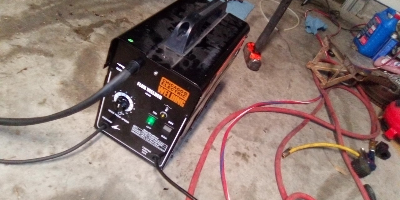

    125 volt harbor freight fluxcore with a 10 dollar bridge rectifier
    Not bad I'd say

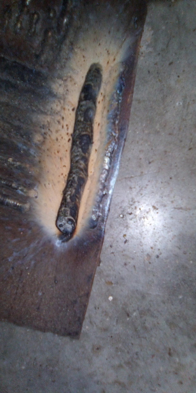

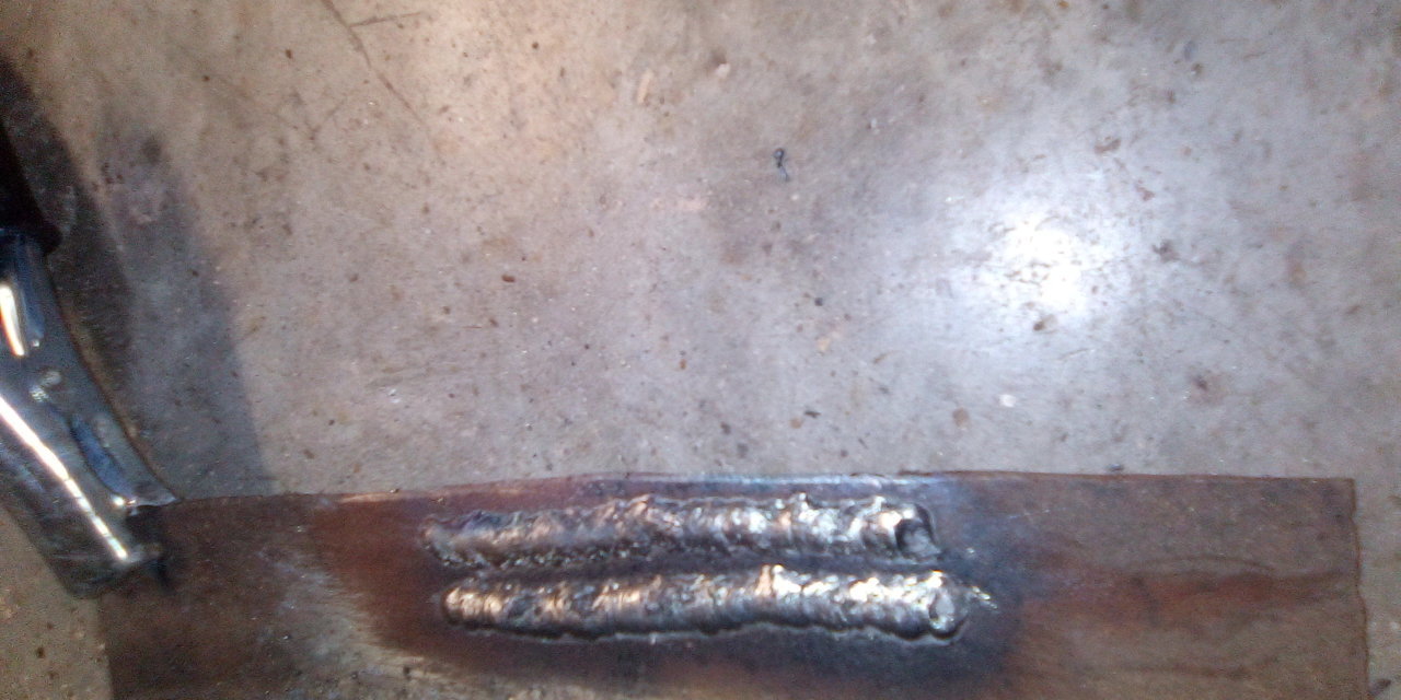

    For someone so young, you sure take shitty pictures :rofl:
    On another note, those welds are better than anything I can lay down by a lot :anonymous:

    Looks like cat poop

    I have a 25 dollar Walmart phone
    I don't take pictures or video of anything yall would get a kick out of some of the shit me and my buddies do
    The weld, those were the first 2 welds I made on the machine since the modification if I wanted to waste metal and wire I don't have, it would look much better

    Was it the Chicago Electric brand one or the Green Titanium Easy Flux unit?

    that's always been my problem, I'm impatient
    I only ran the weld to see if it was going to work not to look pretty or hold anything

    Slower wire feed speed
  16. Feb 8, 2021 at 8:19 PM
    Running Board Man
    Running Board Man Well-Known Member
    Feb 19, 2017
    #211024
    8,801
    Slower wire feed speed = waiting for weld to deposit
    When I weld stuff that needs to be held on I run the wire at half the speed I used in the photo
    I can see from the photo the first half of that weld was cold... The way it didn't burn back the rust till the half way point

    You want penetration more than piles of dome shaped boogers:D
    Pretty good for first try with new machine.
