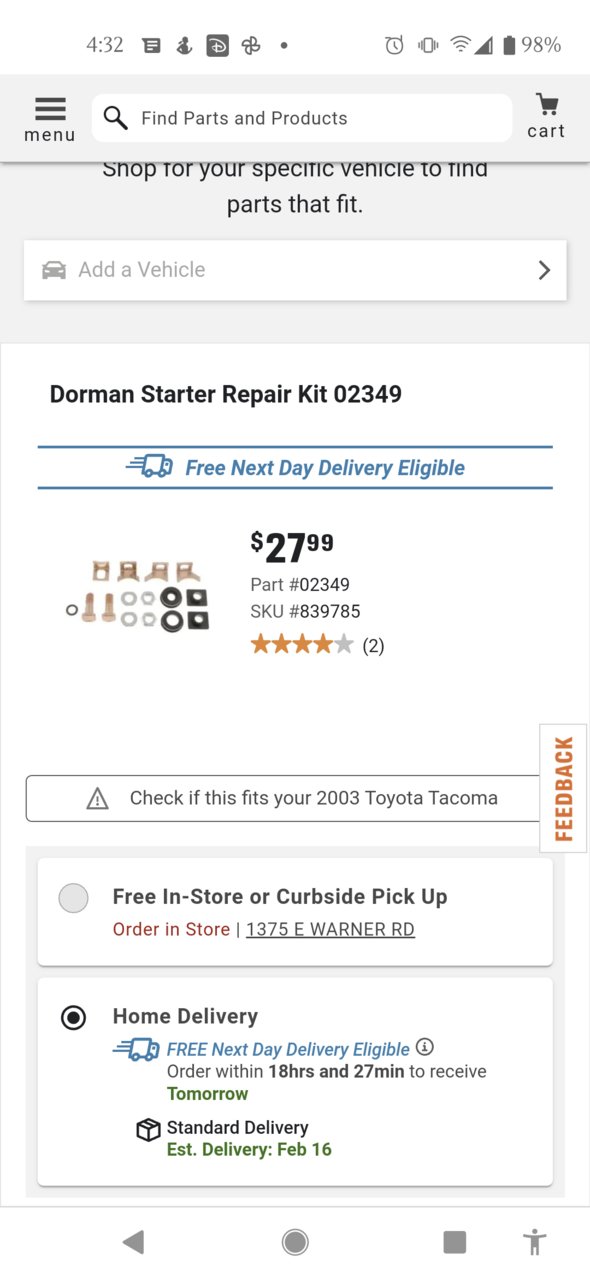

    P sure this is the correct one, but can anyone verify this is the starter kit? Gonna have the gf try to crank it while I wack the starter at the same time this morning, I was only tapping it on my own yesterday then cranking after and nothing.

    I would try a TYC or a UAC from RochAuto. I repaced some troubled OEM parts with TYC and never had a problem afterward.

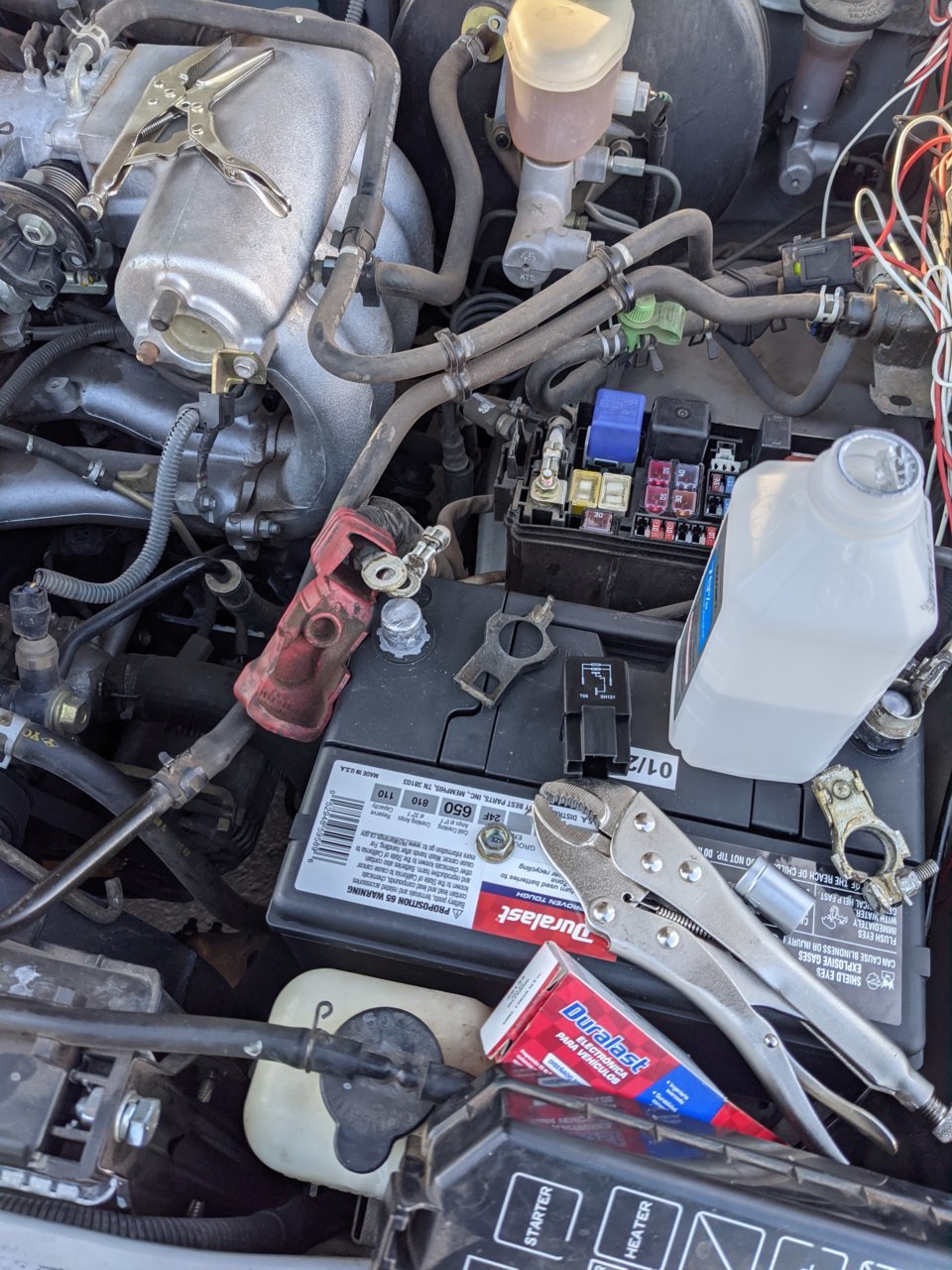

    Update: I can hear the click at the relay in the fuse box, but climbed under the truck and even tapping with hammer the starter was silent. Relay died?

    Sure you don't have any loose battery cables? It seems awfully sudden.
    Might tap on the solenoid too

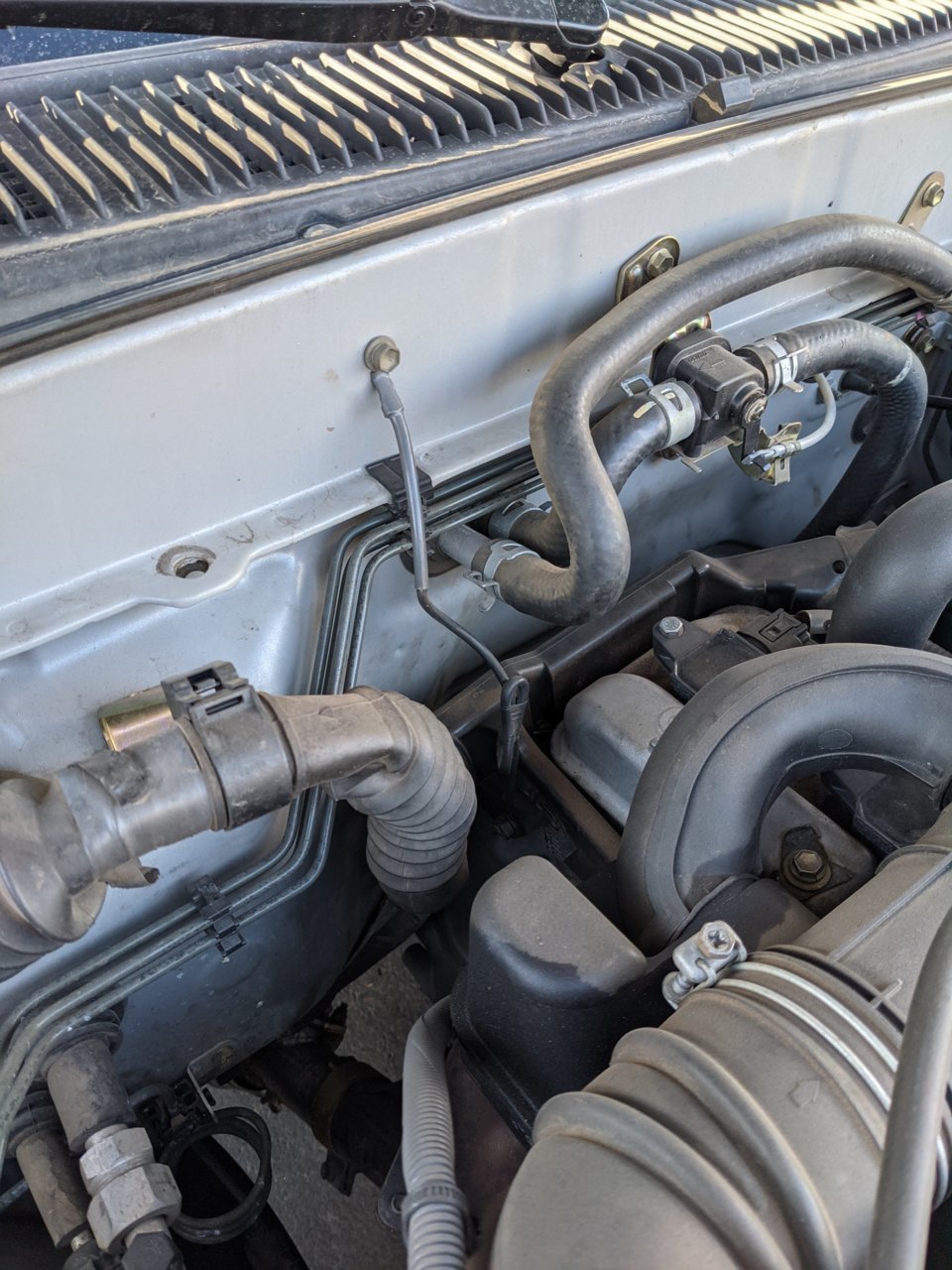

    Reading through your troubles last night sound like an issue I had when I put my rebuilt motor back in the truck.
    It's a long shot but check all the negatives, there's a black wire going from the head to the fire wall on the passenger side, make sure that's not broken or loose. Same kinda wire on the driver fender wall ... I was say there's a third engine block ground but I don't remember where that one is, sorry

    Do you own a multimeter?

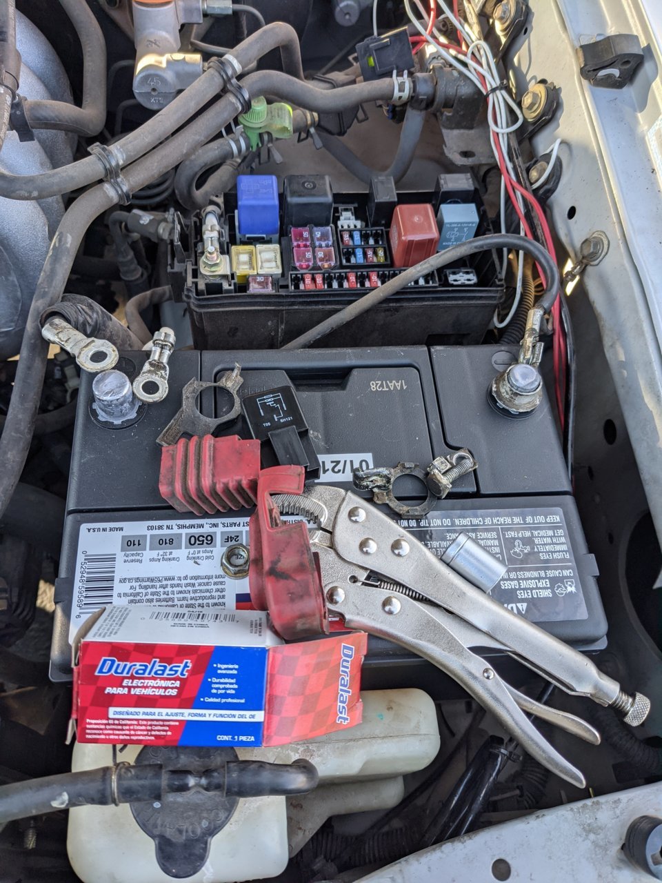

    New relay, still clicking at the fuse box. Tried bypassing the battery clamps to rule out corrosion and still nothing. Safe to say starter still? Bout to go grab the rebuild parts it's just crazy how fast it went without warning

    How old is that battery? Can you post a video of the clicking?
