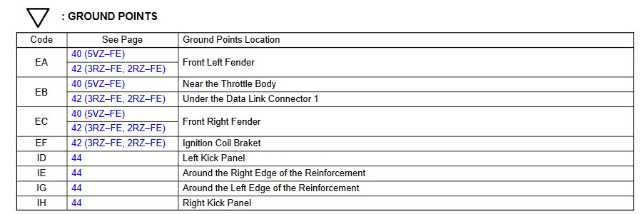

    All your grounds are good in the engine bay? Battery post to inner fender, back of engine block to the cab and I think the other one is from the engine to the starter? Those are the 3 on the 3.4l v6 anyway

    I didn't have any issues from a detached battery --> fender ground once, but I've heard it can cause problems if one or more of those grounds comes loose.

    Yup. Or too much oil/dirt builds up on them. Of course I'm not sure where the 4 banger grounds are.
