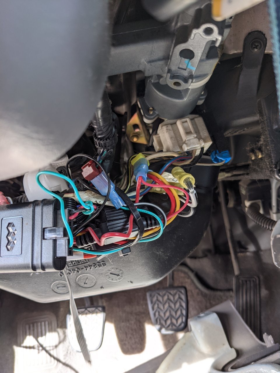

    1996 T100 SR5 MT
    Stock again- rip slug
    U see the wire that fell out?

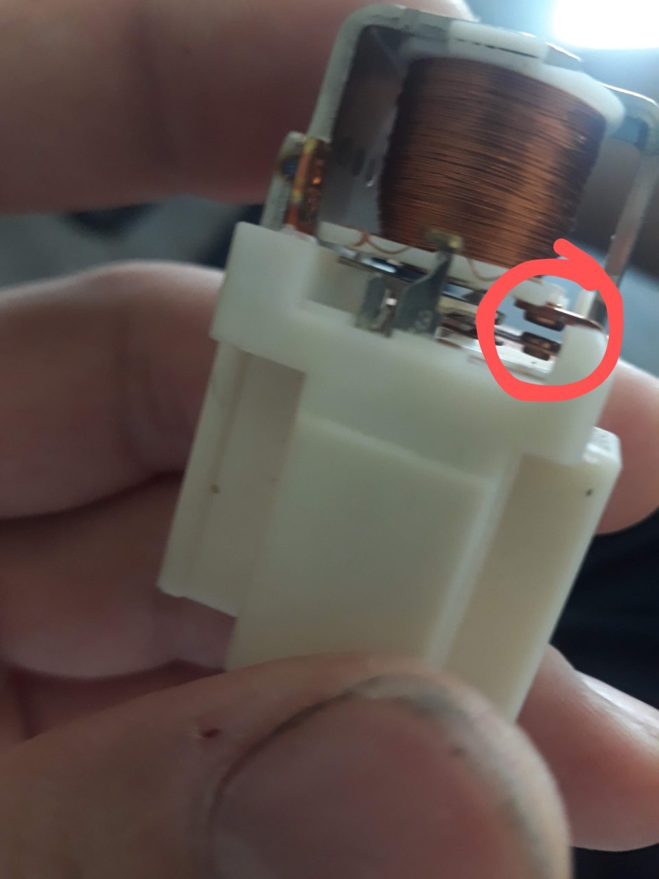

    Take the cover off the relay and touch those two togeter making great effort to not touch anything else if you're using the tip of a knife
    It will crank no mater what if the starter and wiring is good

    Lol so your starter was fine?

    Well that’s as designed, the coil isn’t energized so the switch isn’t closed.

    Yup. All it was was the dealer installing wiring shitty. I plugged the wire back in and it fires fine smfh

    Yeah I understand how it works but my phone didn't want me to type anything so I just posted the photos and edited text onto it

    Jesus tity fucking christ
    I hate aftermarket alarms
