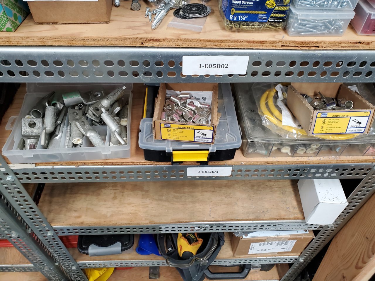

    Stupid starter:(
    Yea that would be awesome if you've already got measurements then I can build him what he needs
    What hole size on the lugs is required? I've got a poop ton lol20210222_081821.jpg

    The studs on the alt and starter are M8x1.25 so whatever you've got that is close. 5/16 lugs are so close but a couple thou shy, with a file they fit tho. I guess 3/8 works too but is a little sloppy.

    Cool, I've got 5/16 lugs and I'll ream em out to fit M8 bolts. Whenever you're near that cable length info if you wanna send it my way that'd be greatly appreciated
