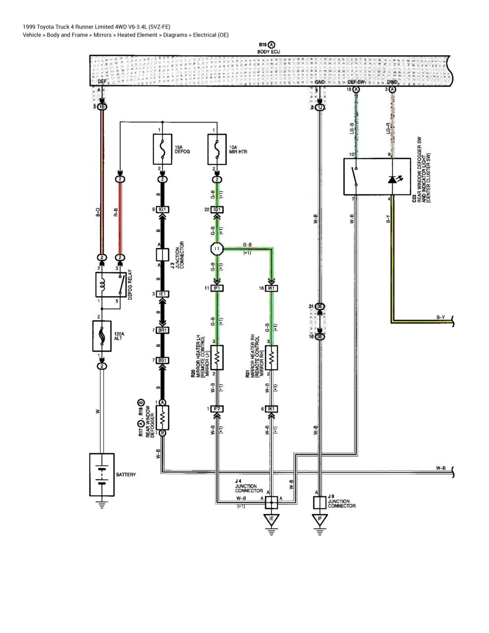

    @JKO1998 Jaxon Flaxon Waxon, does your truck already have the factory power mirrors?

    Also if your plan is to re-pin the door harness in your truck to the 4Runner mirror, the connectors are very different and so is the pin size (probably)

    Thinking back now, I don't know why I thought this would help me.

    I was thinking I could just plug these fuckers into my existing plug and whatever wires aren't in use (heat power/ground), I could just snip them and ground somewhere and then run power to a switch.
    They don't teach that shit in environment school

    The pins are probably different sizes. I know the Tacoma mirror and the 4Runner mirror use completely different connectors, and potentially terminals.
    Just do it the redneck way and run the wires with spade terminals. You can even clip the pigtails off your old mirrors and solder the motor wires to that, and using spade connectors for the heating element.
    I'd just wire it like they did in the 4Runner tbh, inline with the defroster circuit. You can't forget to turn it off and it won't kill you battery, because I'm telling you you're definitely gonna forget it's on and be sad when your truck won't start.

    Switch panel automatically turns off :luvya:
