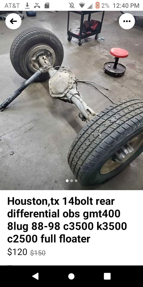

    Now to find someone who cuts them down... I know a guy with a grinder thats alright with a welder
    I swear to God if I can piece together a 14 bolt setup for cheaper than ecgs will sell me a diff with a trutrac I'll stfu about trutracs

    Lol you need someone with an axle jig
    If you don't weld it perfectly you're gonna have a bad time. Prob have better luck finding a Sterling or 60 rear out of a E350, i think those are only like 66" wms

    Now an axle shaft
    And a driveshaft
    And the ebrake
    Custom hydraulic brake lines arnt a big deal

    It can be done but budget for hidden costs

    FWIW custom shafts are about 600 ea from RCV. I think moser and dutchman offer similar

    5 inches wider than stock
    I have 2.25 spacers on my truck right now so I guess if I get wheels with the same offset it would be identical to what I have now

    Get some oem dodge wheels with like 6" BS
